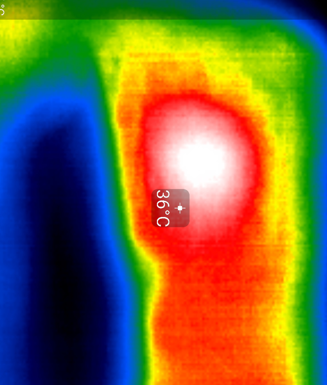

I removed the wifi/bt shield and discovered the chip is getting visibly warm even during the moments when it’s not being used (safe mode). Is this normal?
It is approximately 2-3 degrees hotter than the surrounding PCB, similar to dialog ID etc.
On a similar topic, will PS5 boot without the module? I could just remove it and see if it stops hanging the apu. :slight_smile:
