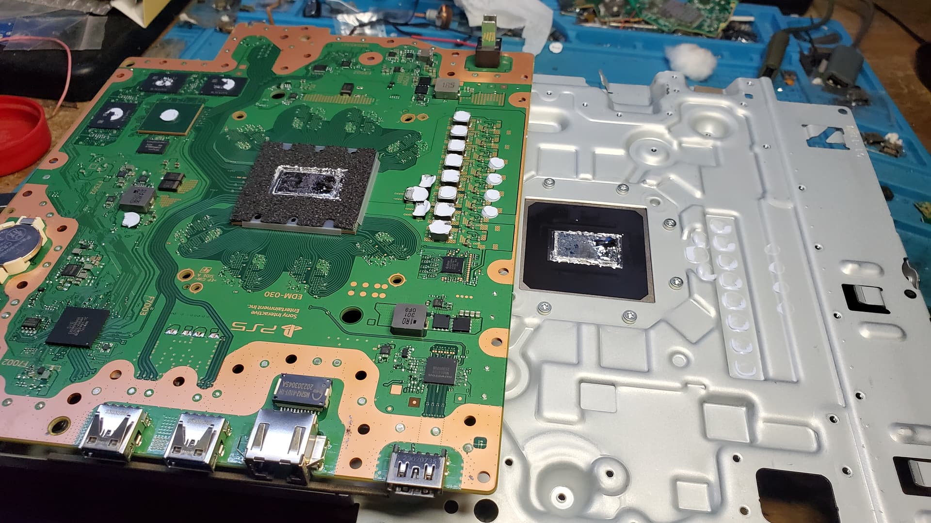

PS5 EDM-030 random shutdown
Hi guys ,any idea?
Try…
Change liquid metal and clean heatsink and surface APU.
Tried another power supply
The random shutdown happen at diferent times
Testing
1 hr , 40 mins , 20 mins, 5 mins , semetimes instant.
All random
suggestion?
Sorry for my bad english, i using google traslate.

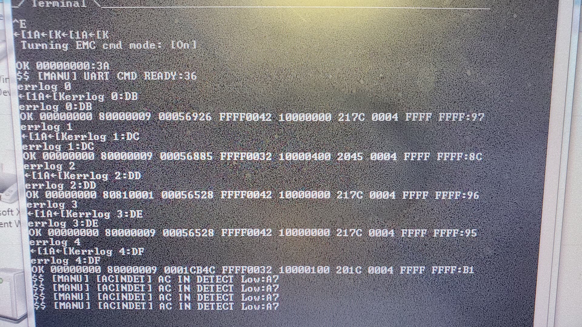

Are there entries at the error history menu?
Did you checked UART error logs from the southbridge?
:slightly_smiling_face:
80000009 APU unexpected power outage/shutdown failure
80810001 general power failure (periphery,gddr6,APU, data line shorted)
Check fuses , caps and coils…

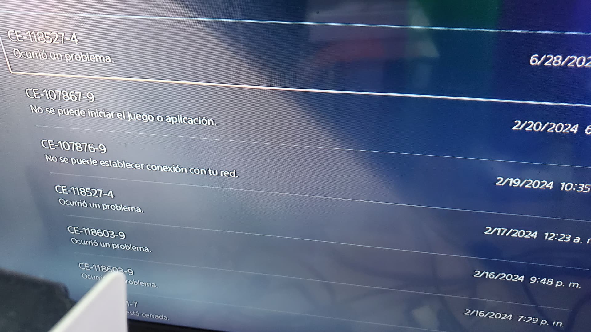

Sadly unspecific error codes. When the PS5 is startet, do you have in the history menu error entries?
Error history, thanks you for answering
