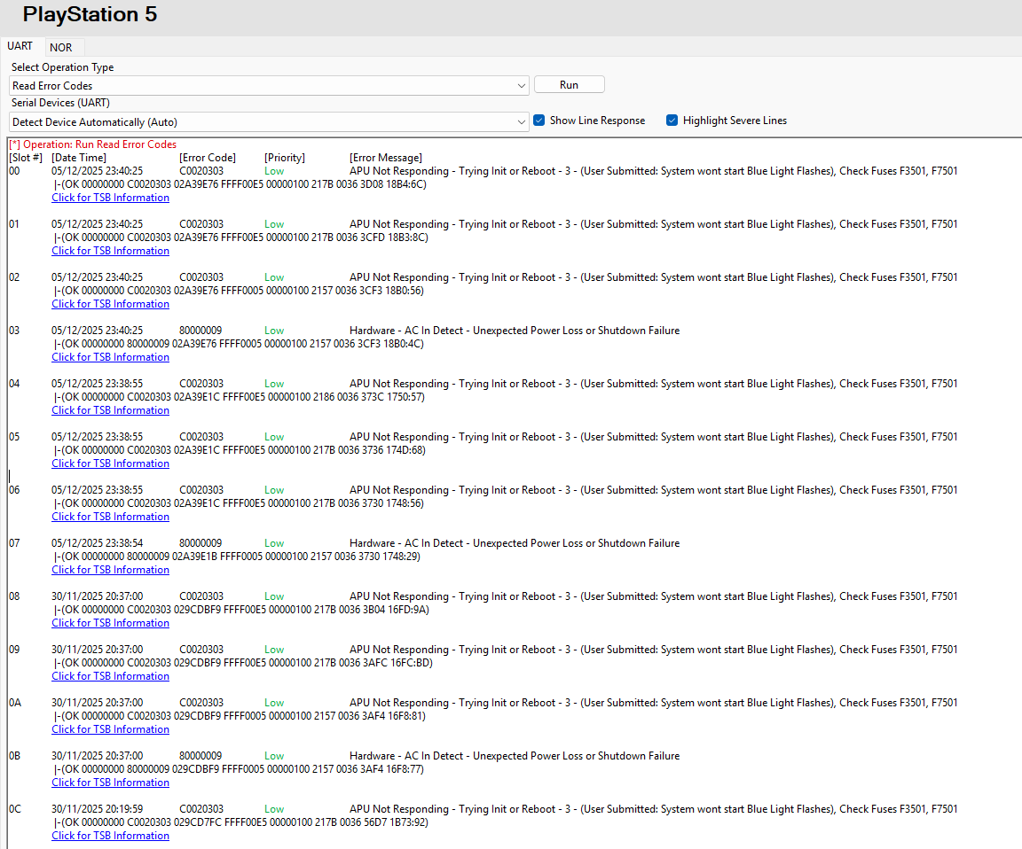

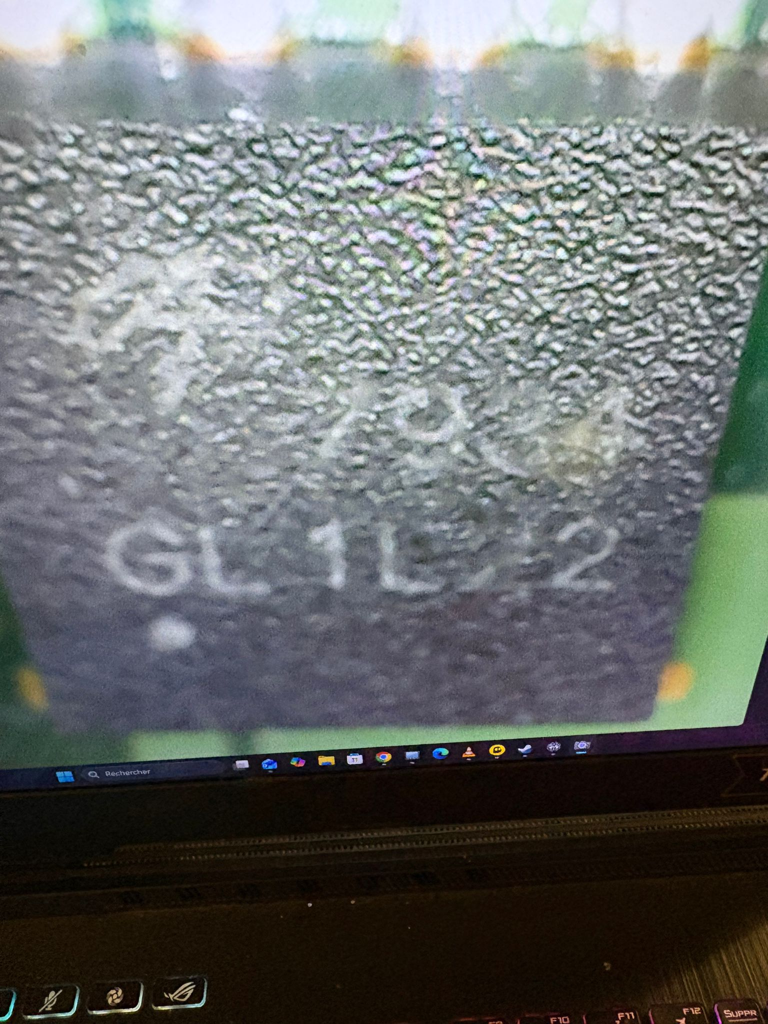

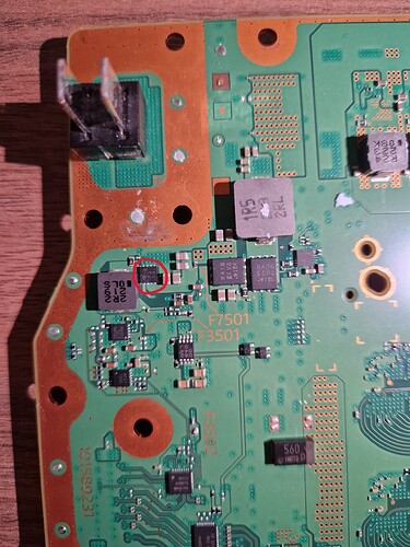

In UART mode, the console simply reports that the APU is not responding and asks to check the F3501 and F7501 fuses. I tested them and they are fine, he chip is the 7934 GL1L22.

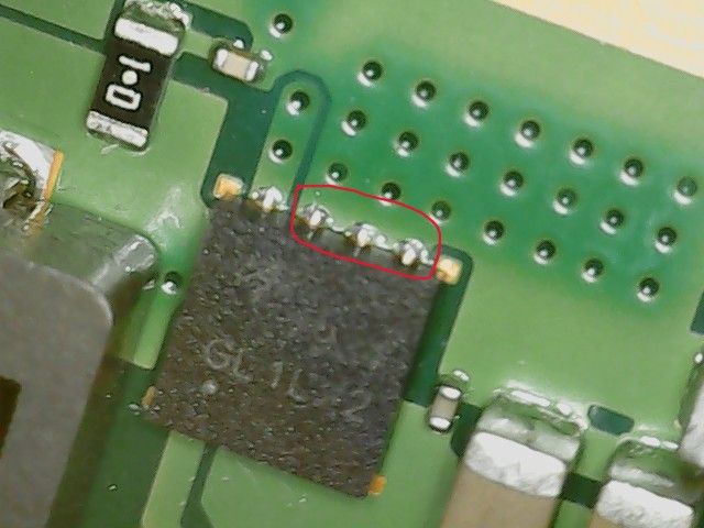

Next to those fuses, there is a chip with three aligned pads that appears to be shorted, but I don’t know what its function is or whether this is normal.
Does anyone have an idea or any suggestions to help?
