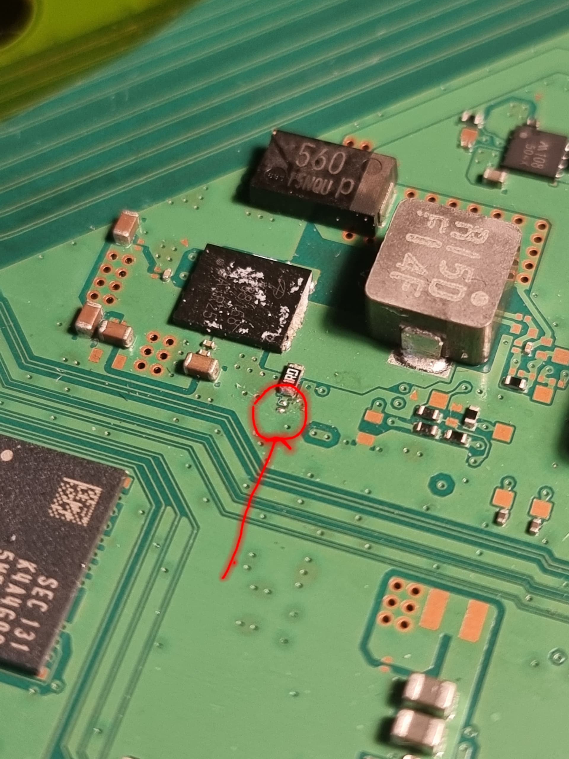

So I’m trying to repair this ps5 I have and it is no power no beep. EDM-020 Blueray.
12 rail is there but 5v and 3.3v rails are missing. I found a missing cap on the board and would appreciate anyone who is able to identify the value of the cap that needs to be there. Thanks in advanced.

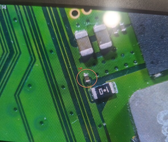

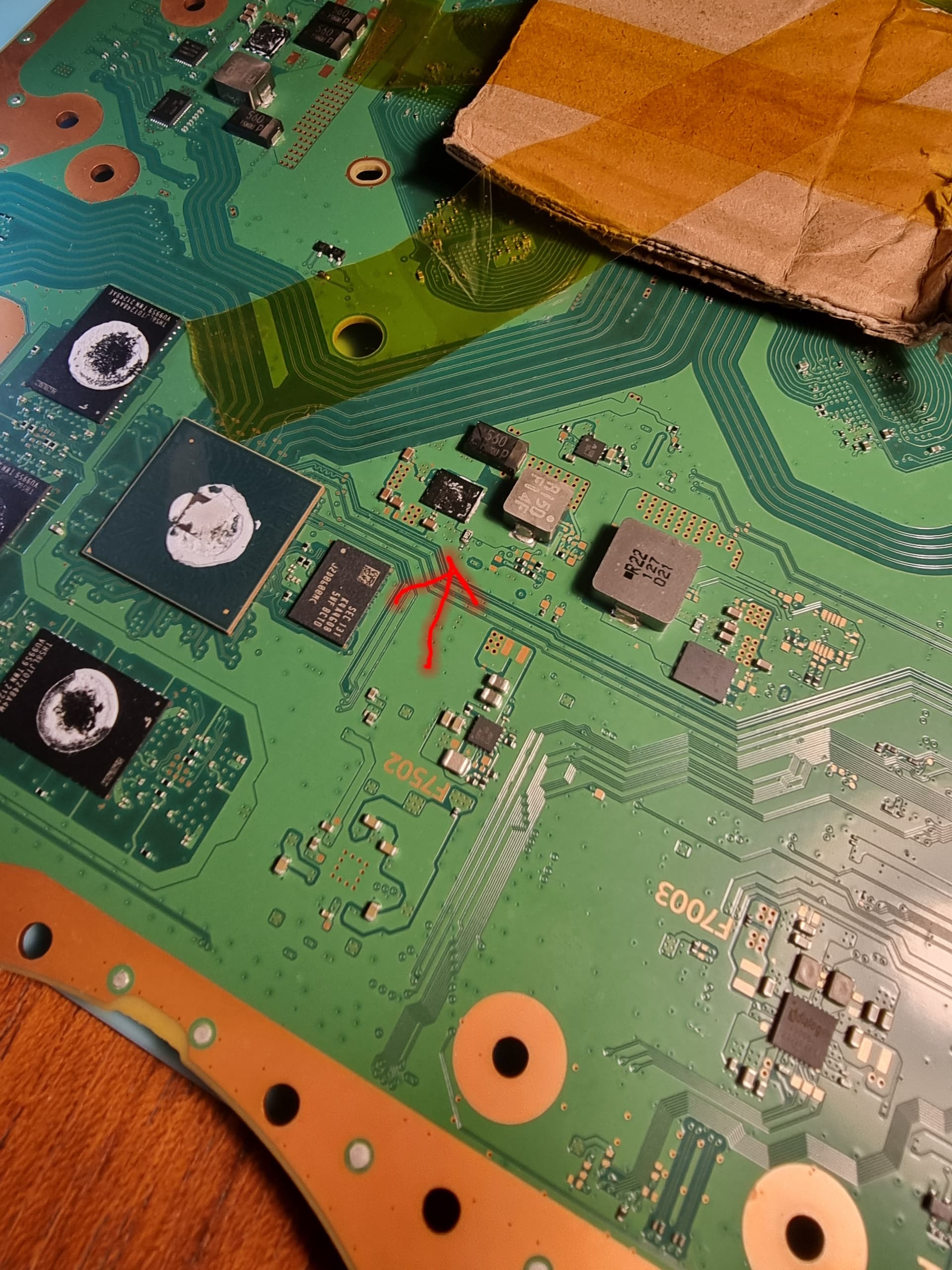

my board is slightly different with the cap being “above” the resistor. But they look the same. Mine is 1nF. I will attempt to post a pic.
There are other differences in the board revisions, but I can confirm this is the exact same area on my board to your original pic
