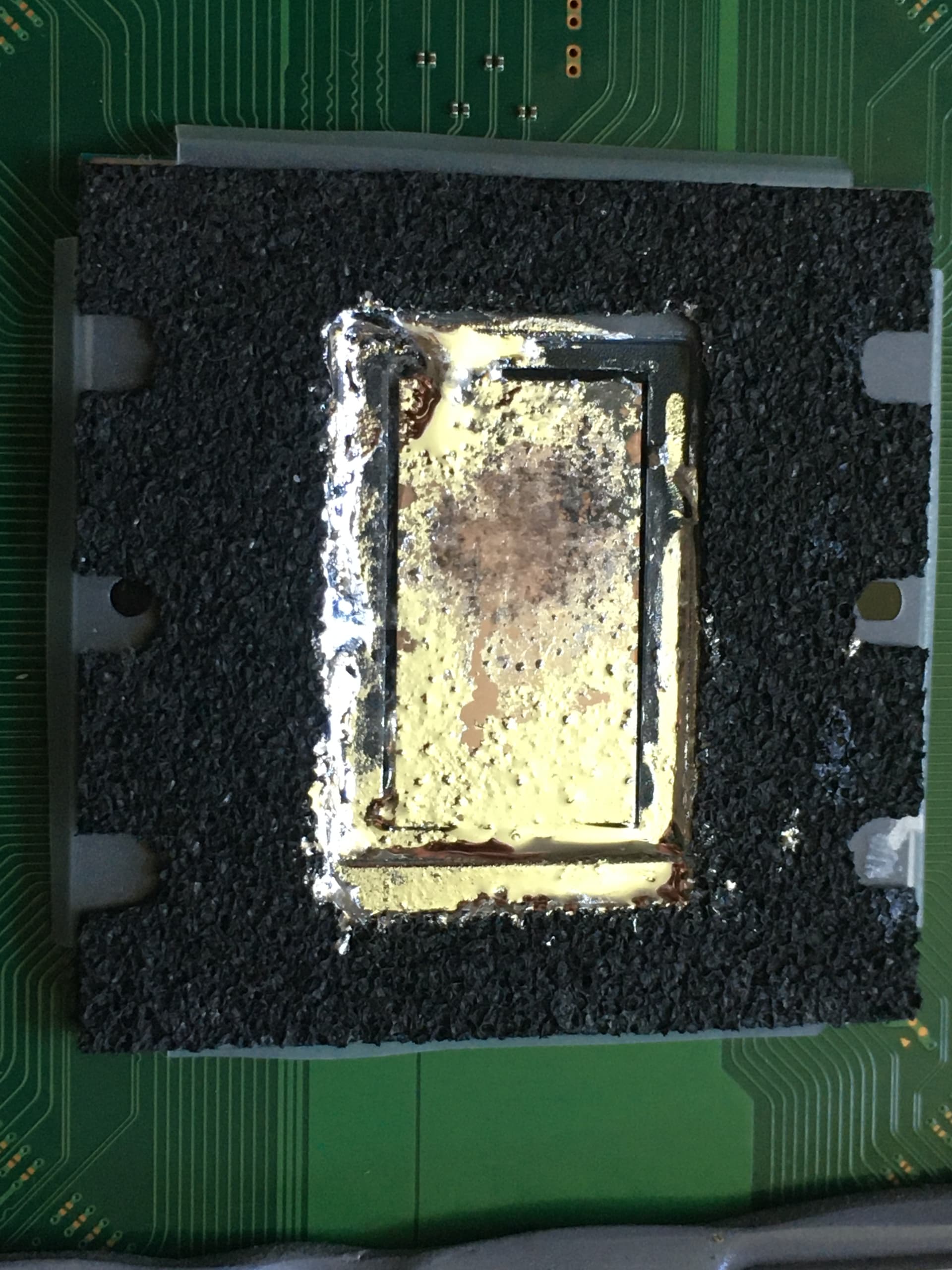

The PS5 is getting hot realy fast. So if the fan isn’t spinning or the cooling system is clogged with dust and allows not enough airflow, the PS5 can shout down before started completely.
If your fan is spinning and the cooling system is clean, I would check the liquid metal on the SoC. The liquid metal tends to oxidize and builds up dry spots on the surface of the SoC, which also causes in problems in heat disappearance.
