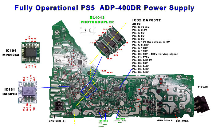

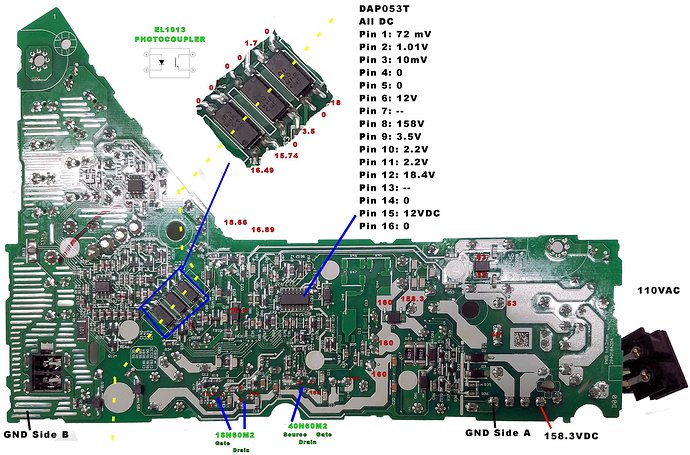

PS5 power supply voltage
PS5 power supply voltage. Thanks to Nanbito for making this information public.
