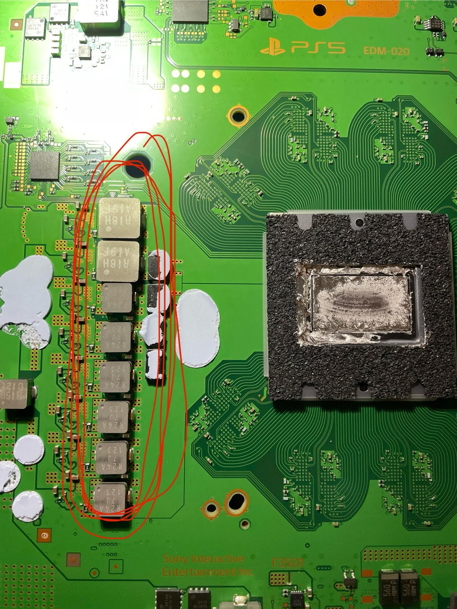

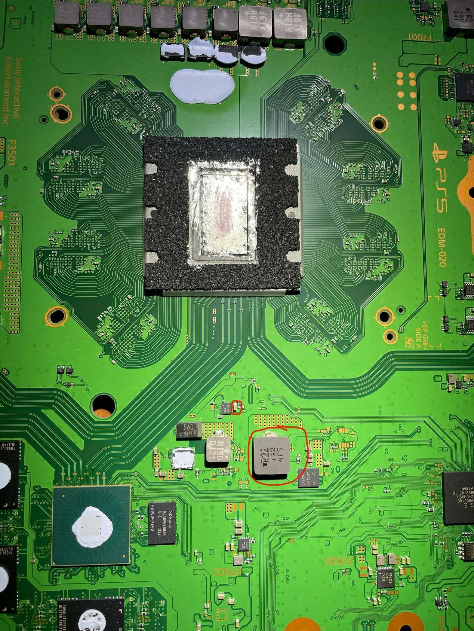

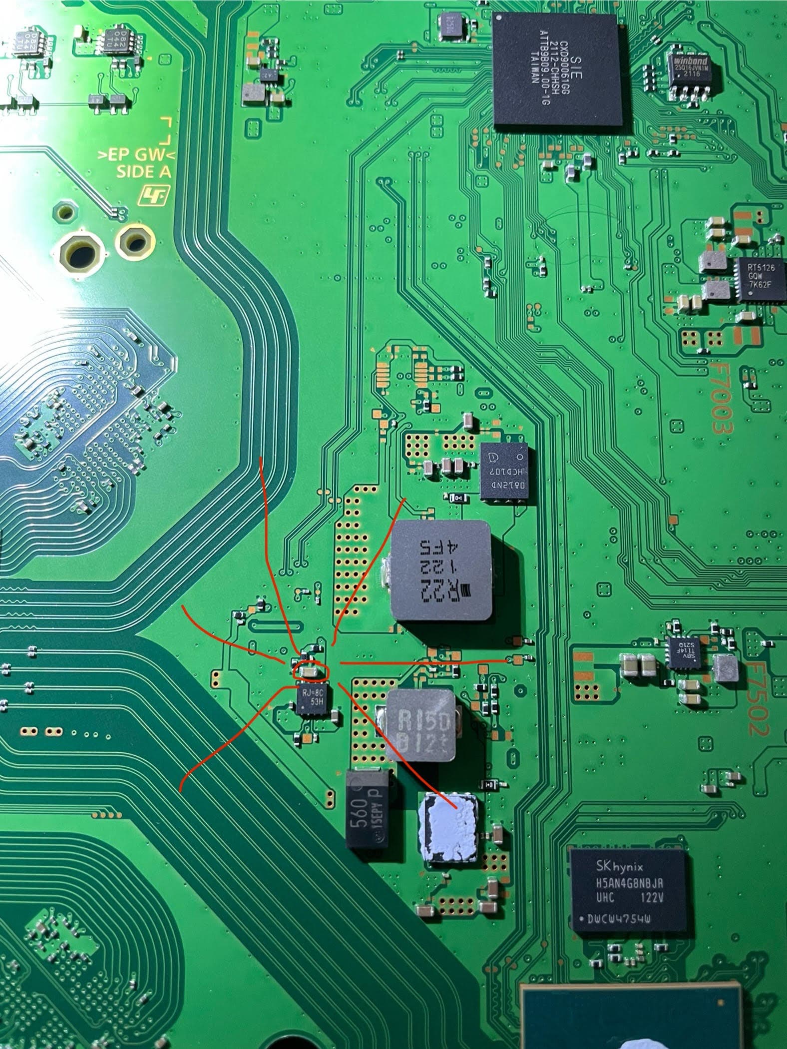

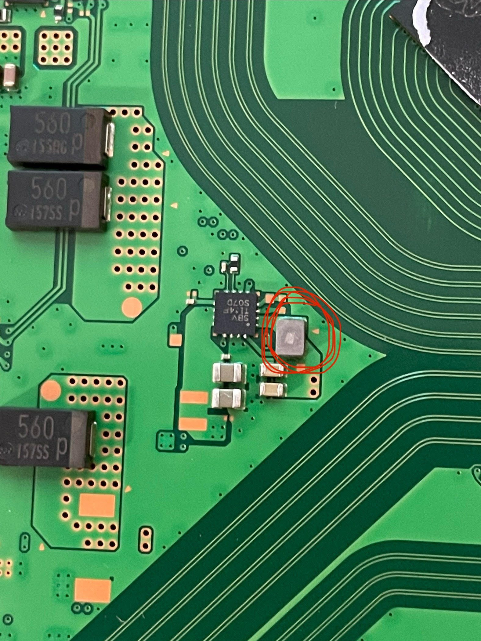

I am having the same issues as well like @Calvin said. I found shorts on mine in the pictures. Can anyone with experience repairing PS5s advise one what these components are and or how to fix I have lots of soldering experience and was hoping someone could tell me where to look. I’m not sure if the big bank of components is supposed to have shorts but they do. The crispy looking component looks like it’s tied to the other side of the board at the other circled component. Thanks everyone I’m new here go easy on me I’m not a professional.
I don’t believe I have upload ability as a new user yet. So my post doesn’t make sense without the pictures…
What are the actual resistance reading to ground? Also what resistance do you get when you touch both leads together?
@johnny_debt the resistance to ground of the cap is 231 ohms and the coil big one labeled R22 is 23 ohms
sorry forgot both leads together is .4 ohms
