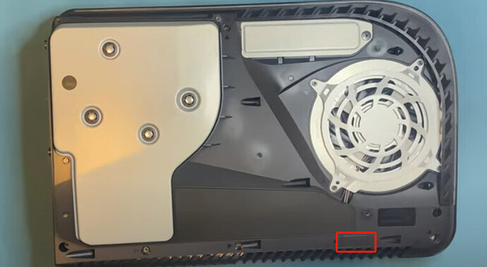

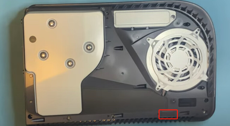

Do you see the seal sticker been removed/worked on?

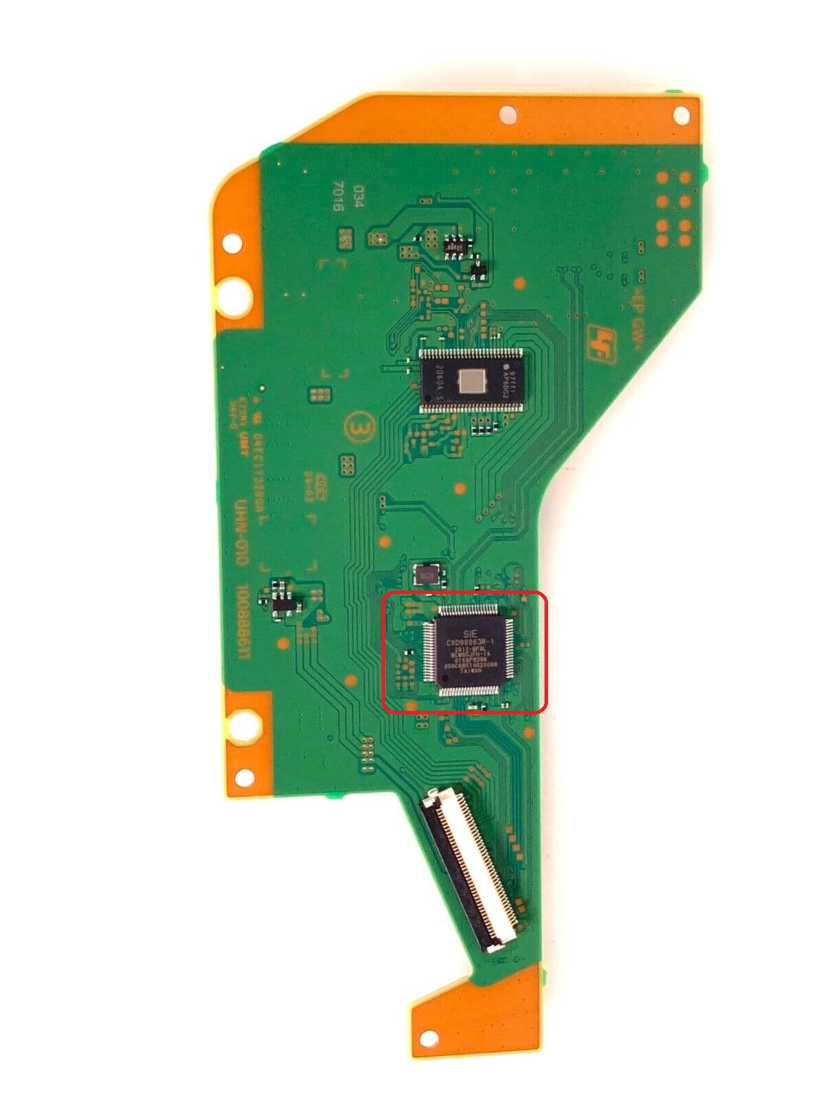

New laser will fix most disc reading issue. However if your disc drive board been swapped already, nothing you could do to make it work
Why? is the pcb from the disk drive linked to the pcp of the ps5? or why do you think it will not work if i replace the disk drive?
Yes, the disc drive board has the SIE chip married/encrypted to the mainboard SOC. so it won’t work with different daughterboard.
Okay Thanks, but what works with another board? and is there a way to check if the board matches the pcb chip?
If your void sticker still good never been pilled off, your daughter board highly match. Else you could only install game disc to insure the board matched to the console.

I believe only CD, DVD work with unmatch daughterboard. I tested DVD only. Game disc cant recognize from unmatch board.
check if the sticker still all black or you see marks on the sitcker
the sticker on the disk drive? or the normal warranty sticker?
on the black hosing(check my upload picture). under the sticker has a hidden screw. You have to remove all 15x T9 and 1x SSD cover Philip screws in order to take out the disc driver in general.
Okay i think this sticker was alrady gone. But i will try replacing the laser!
