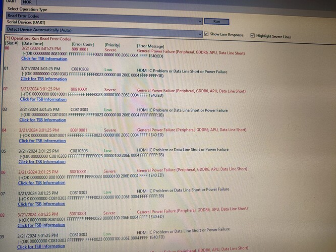

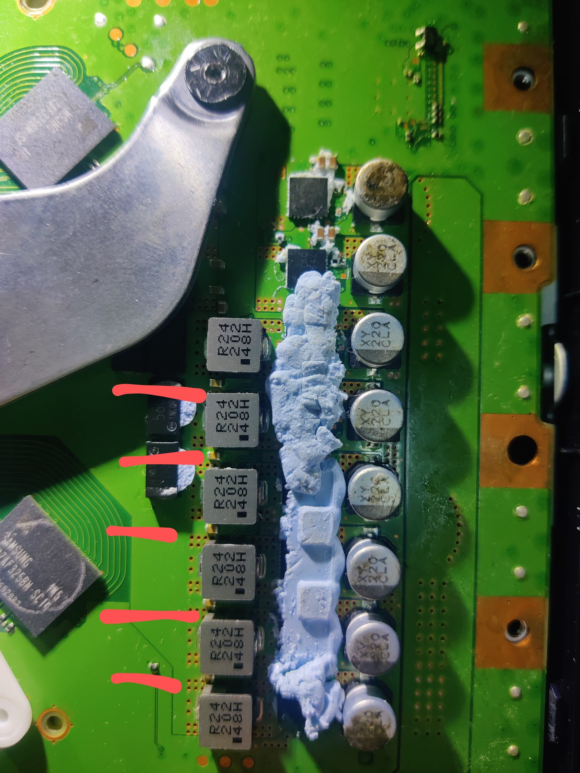

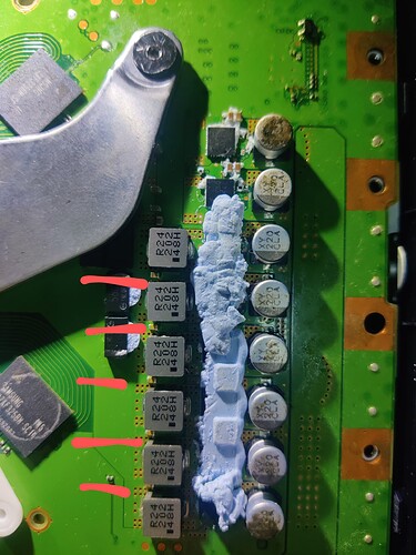

Good day i need help are these capacitors supposed to be shorted? I also got this from UART
If the system is not powered, the APU voltage lines have very low resistance.

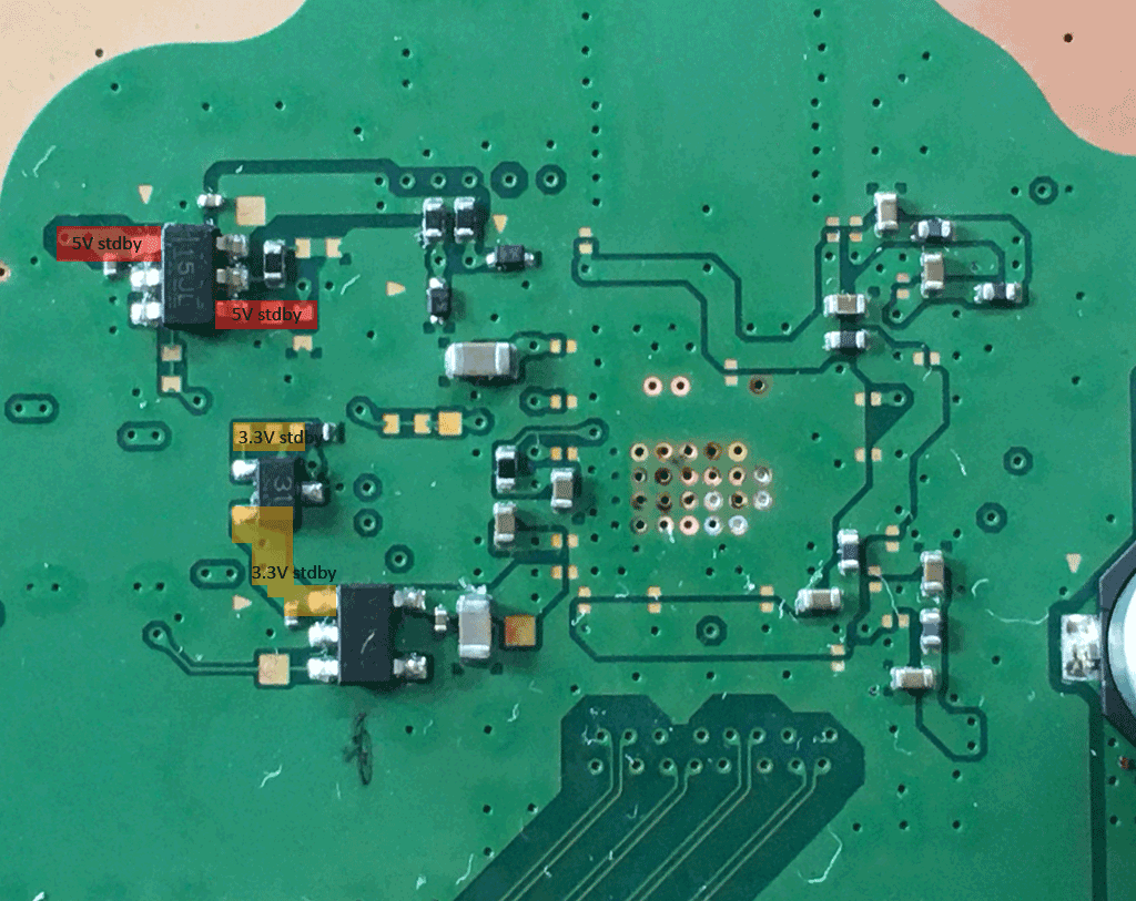

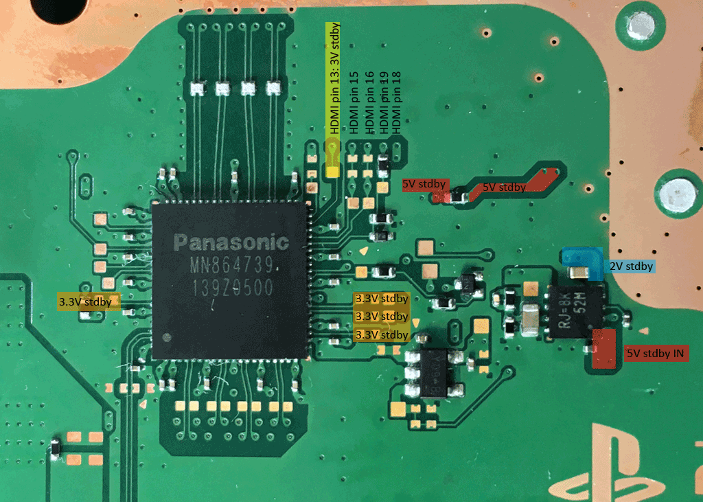

I would first check the standby voltages around the hdmi ciruits.
All the stby voltages present, any ideas?
Then test if the voltages are present in power on state.
