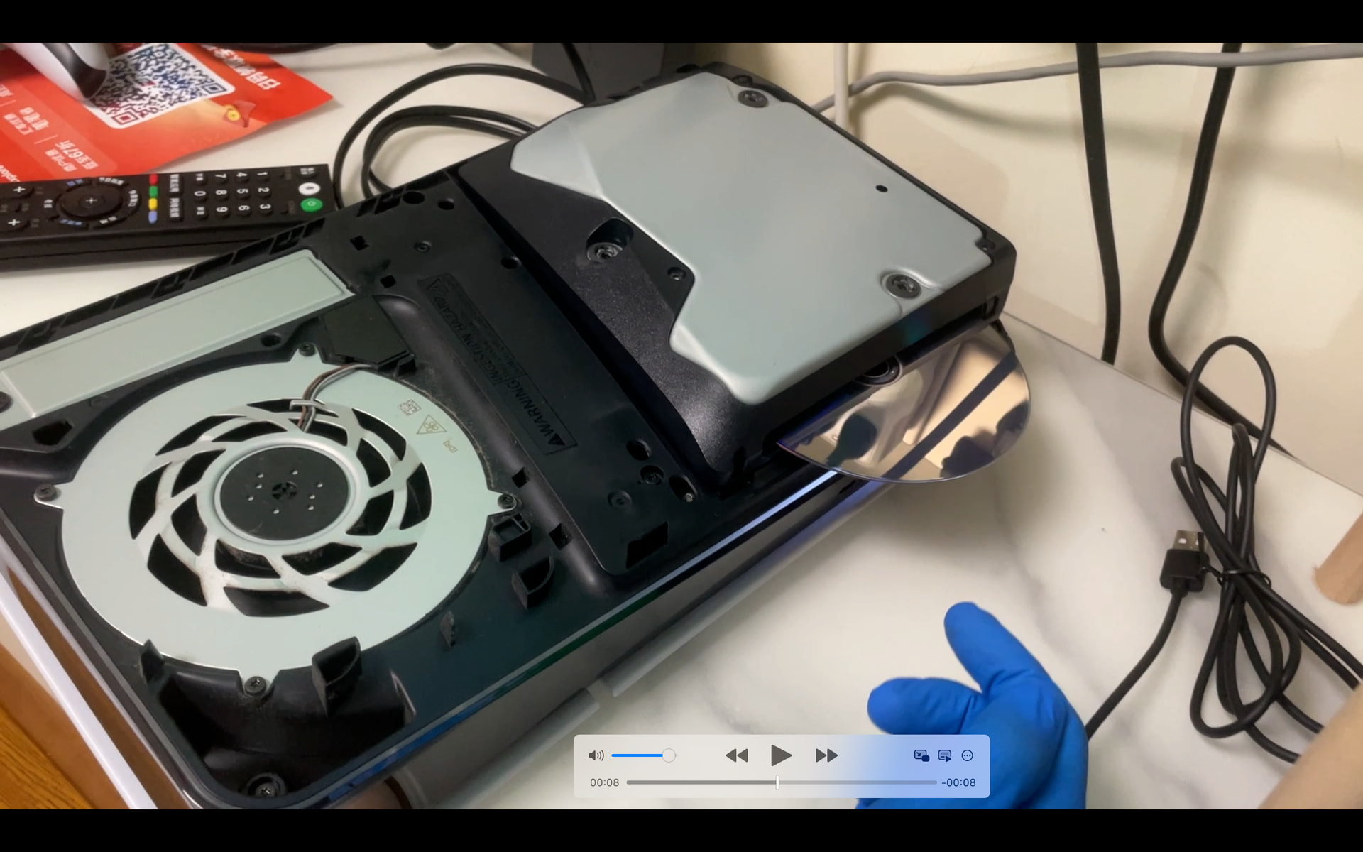

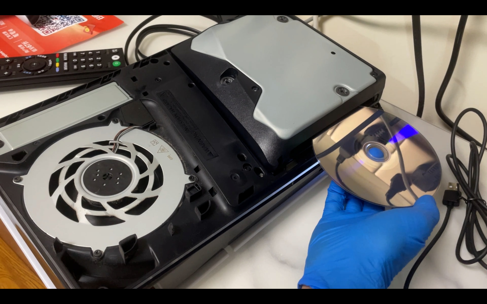

Once insert the disc it automaticlly REJECT without even spinning or reading. After ejecting the disc drive is buzzing for seconds. It also buzz when power on and off the console. It buzz feels like it is even reject disc without any disc in it.
I replaced the laser head and nothing changes. The spinning plate and clip are normal cause mannually insert disc it can spin. I cannot upload video so make two screenshots of inserting and rejecting.
It seems that the disc isn’t reaching the middle position, where it should be clamped or the switch isn’t reporting the inserted postion back.
I would check the unpugged disc drive with the manual eject screw (hole on top of the disc drive) if the disc is getting in read position.
The last cases I had with not taking disc propperly were: a) not correct reassembled disc drive mechanic. There is a white pin which must be inside a long hole at the white gear.
b) in the center element was a spring missing, which led to the disc not passing the middle.
