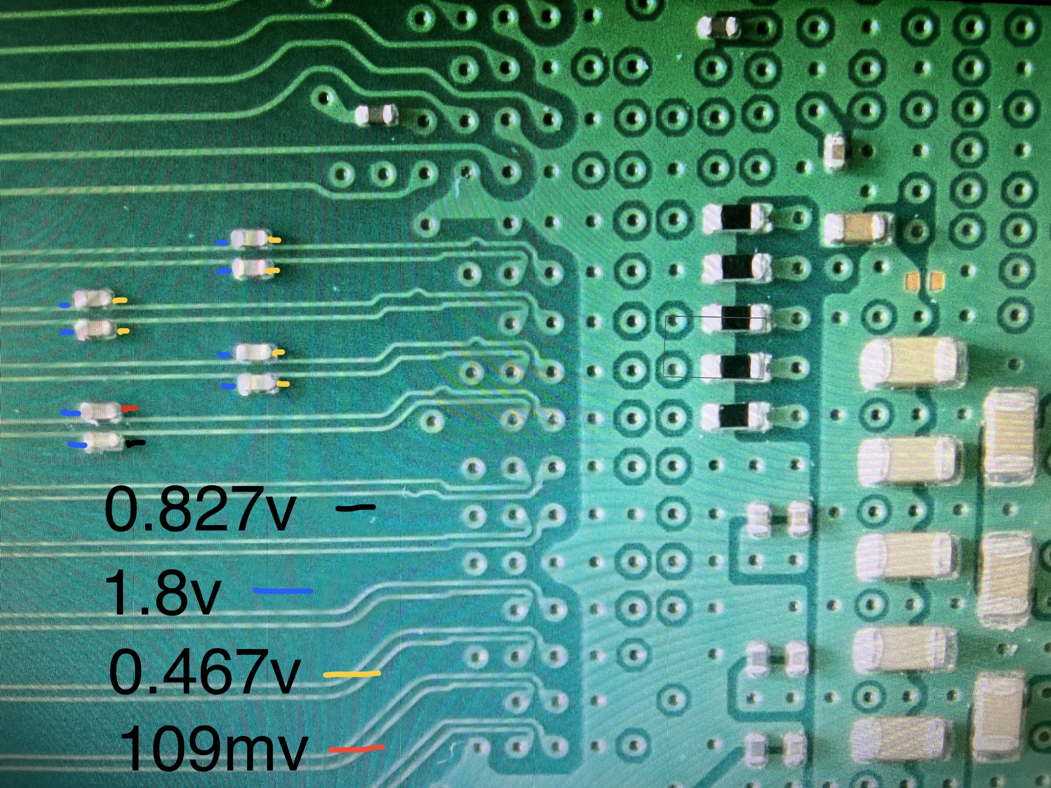

I have this situation at the back of the board. I believe the apu may have an issue. What do you think? These are the differential pairs but I don’t know what these voltages should be
