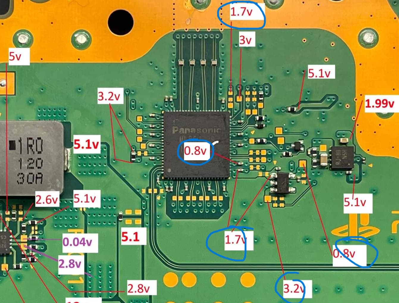

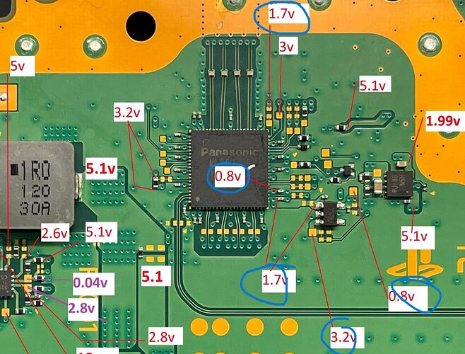

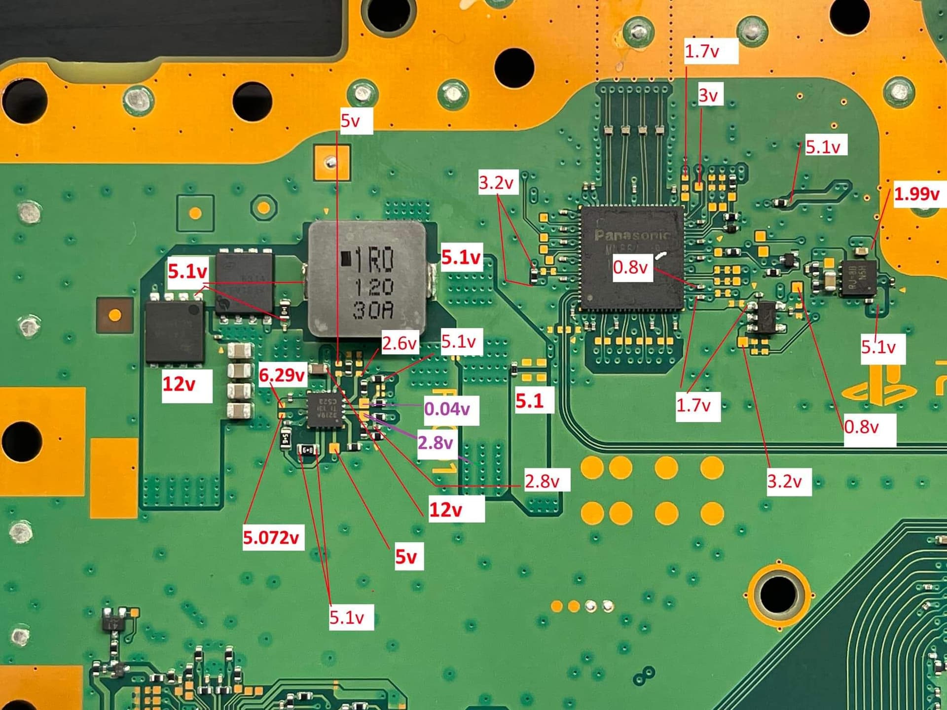

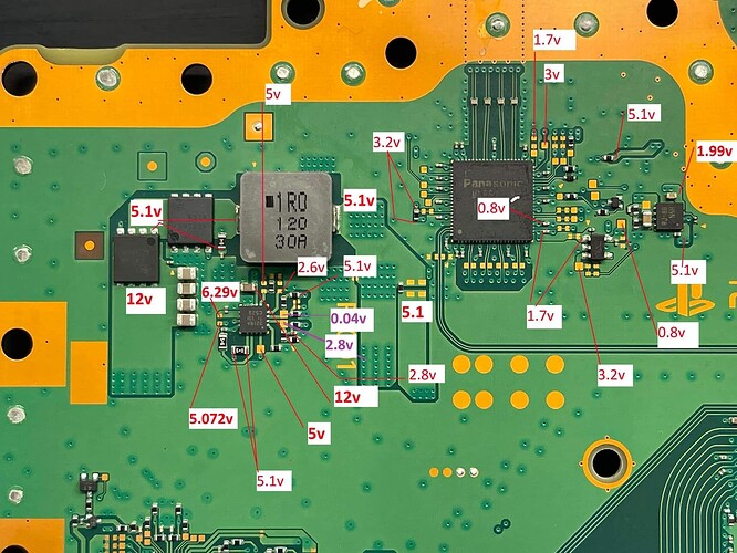

Here is what i’m getting.

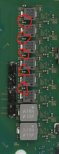

im sorry, i’m missing what’s circled
shorts here
try removing the led board cable
already tried, same issue
I would test those red marked caps while turning the console on. If there is a voltage reading at the line side at those caps, they are not shorted.
shorts or low impedence?
I measured around 0.3x~0.5x ohm low resistance to ground on those small caps on a working board. They are not short but low impedance

  1. 0 exp troubleshooting, find a console repair specialist
  2. have some exp, have some handy tool i.e DMM, bench psu, check for boot up amp sequence, check for short.
  3. Else, take some picture from board with your measurements
