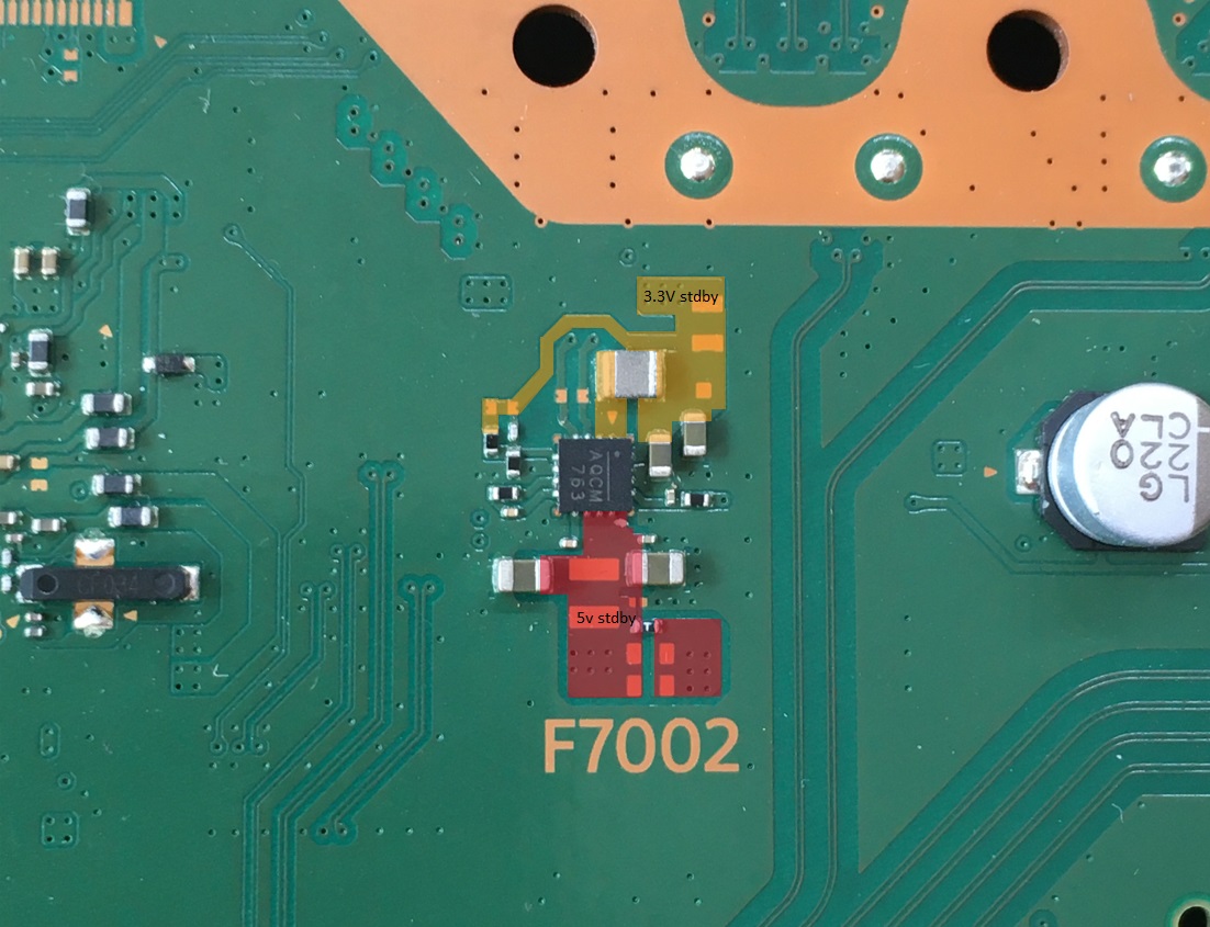

The error code 80C00136 indicates an issue with the WiFi chip. I would check if the fuse F7002 is good and if the output of the dcdc converter close to the fuse and on the backside are showing 3.3V and 1.8V.
I found a 3.3v but cant find a 1.8 volt when measuring from under the hdmi port, f7002 is good

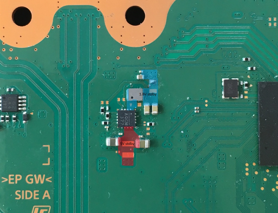

Please check the voltages on both dcdc converter bugs.
If one of the votages is missing or line shorted, check at the dcdc bugs and on the backside of the Wifi chip if one of the caps is getting hot.
I am missing the 1.8v line, none of the caps are getting warm or shorted
I would replace the dcdc bug converter. It is replaceable with a TLV62090 chip.
