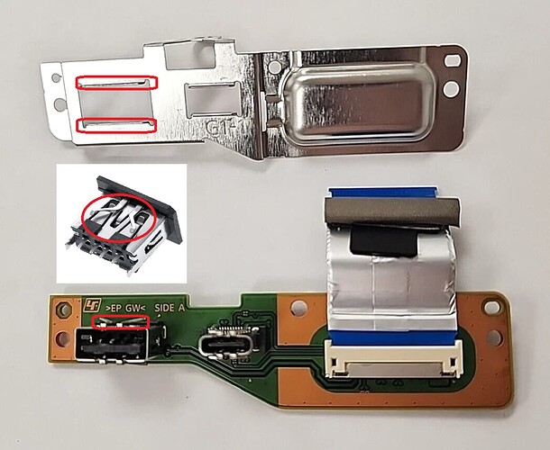

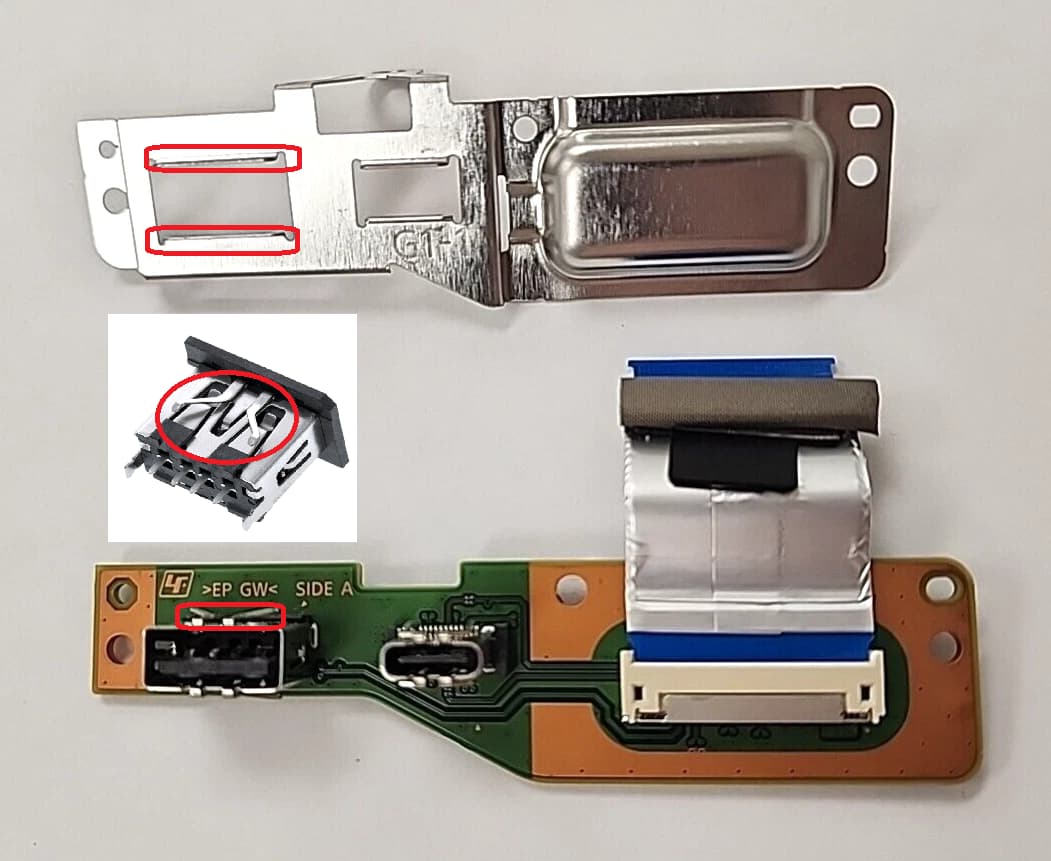

Sorry my bad, they are both made by Luxshare not JAE, so cant find part number. I see TE might have similar style but with no spring lock from entrance
Many thanks for that info Jkyoko, I have located the TE parts through a local distributor - just out of curiosity though what is the spring lock and what does this do please ?
Its the spring contact to the metal shield bracket to the front IO proving EMI shield I believe. No big deal for most people dont use front C port for external hard dive connection
Thank you again for that extra info. Think I have managed to source from a local distributor. Definitely doesn’t have the spring lock though, but as you have advised probably not necessary
