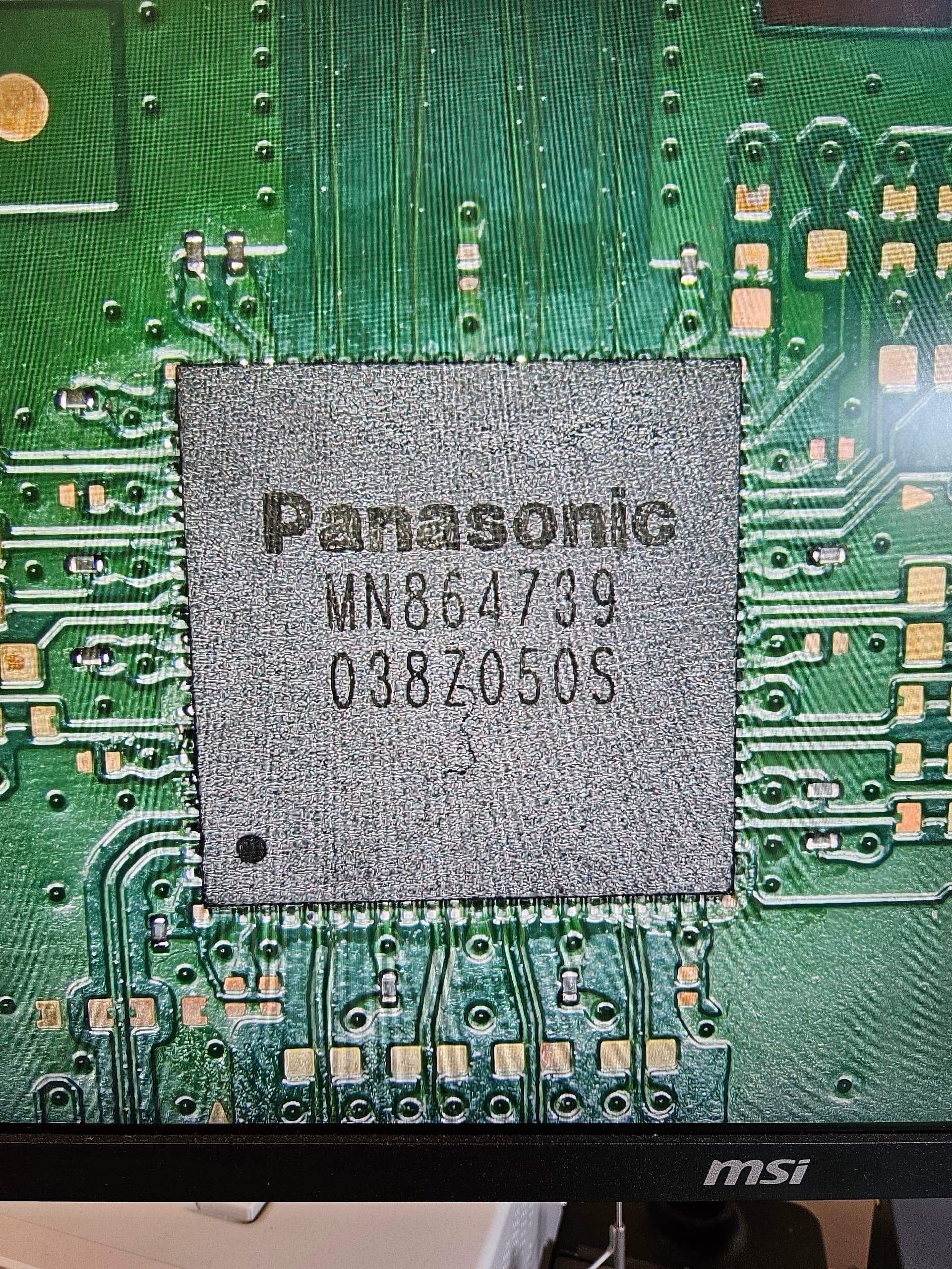

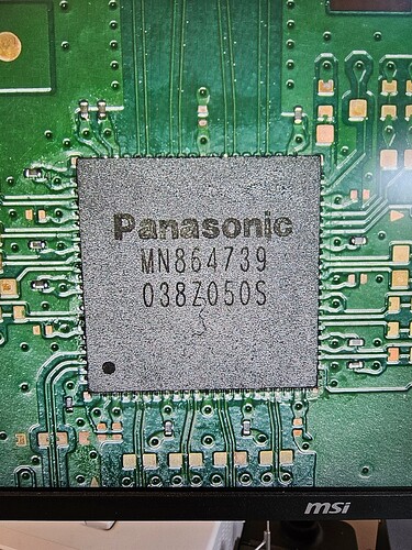

At the beginning I should tell that I get a BLOD and after the UART reading and shorts on the caps near by the HDMI Encorder I change the IC. After the change I get a WLOD.
The caps near by the HDMI Encorder are not shorted now. I also change the HDMI Port.

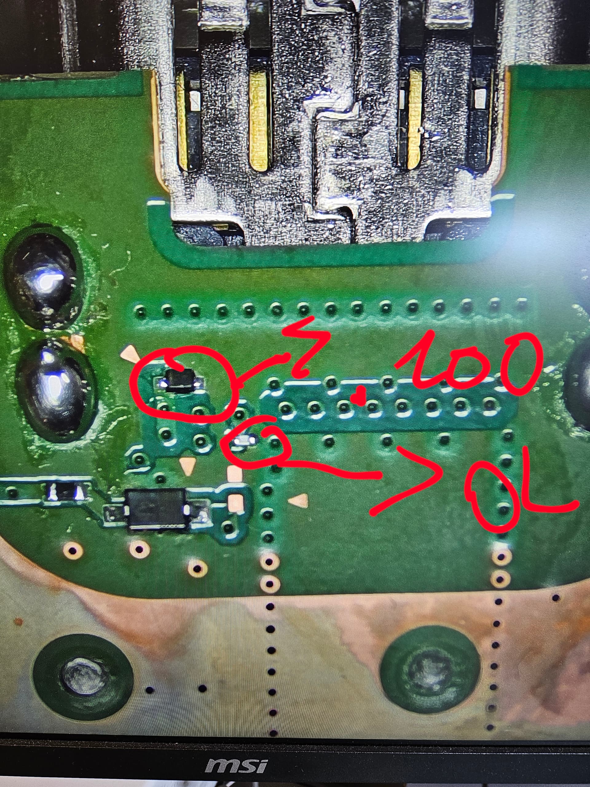

I get some readings in Diode Mode which doesnt look right to me.
  1. HDMI Pin 18 I get 0.100V and Pin 19 OL
  2. Diode on the back side 0,100V
  3. Cap on the back side under the Diode OL
I’m also wondering about the number of caps around the HDMI IC. This model have much less caps like the EDM-010.
