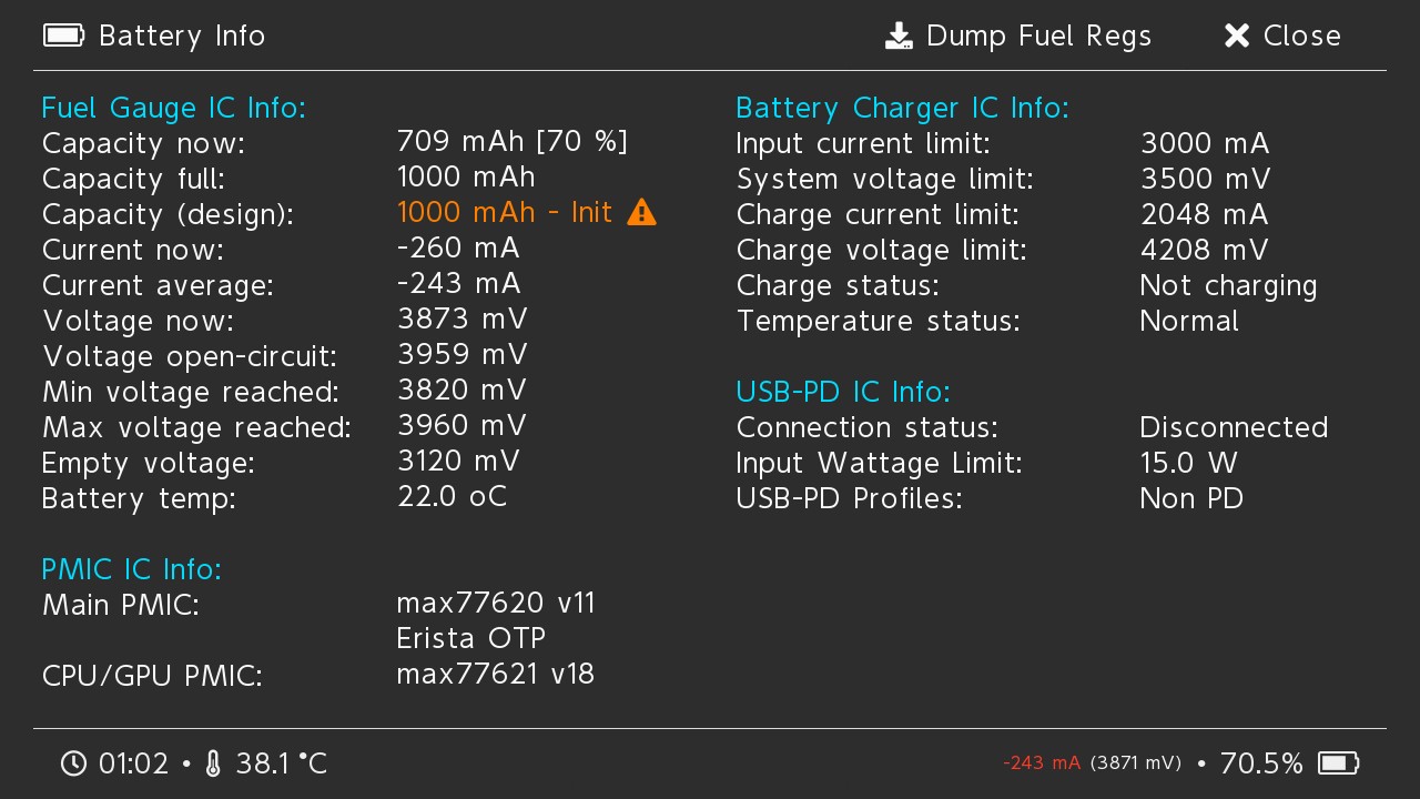

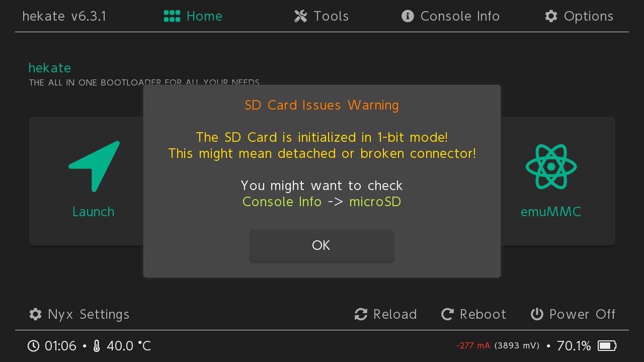

I installed a chip to run a diagnostic with Hekate.
I’m finding several issues (see photos).
If I boot from the emuMMC partition, it starts up rather slowly.
Once it reaches the home screen, it crashes after a few seconds.
I checked and measured the SD card slot connector, and everything seems fine.
I checked the continuity with the card reader, and it’s all good.
I’ve tested several memory cards.
So, I’m wondering:
Should I try a different battery?
Should I replace the fuel gauge chip?
Should I try a different SD card reader?
Or, given the symptoms I observed before installing the chip, could the problem be related to the RAM or CPU, as I’ve read in some posts?

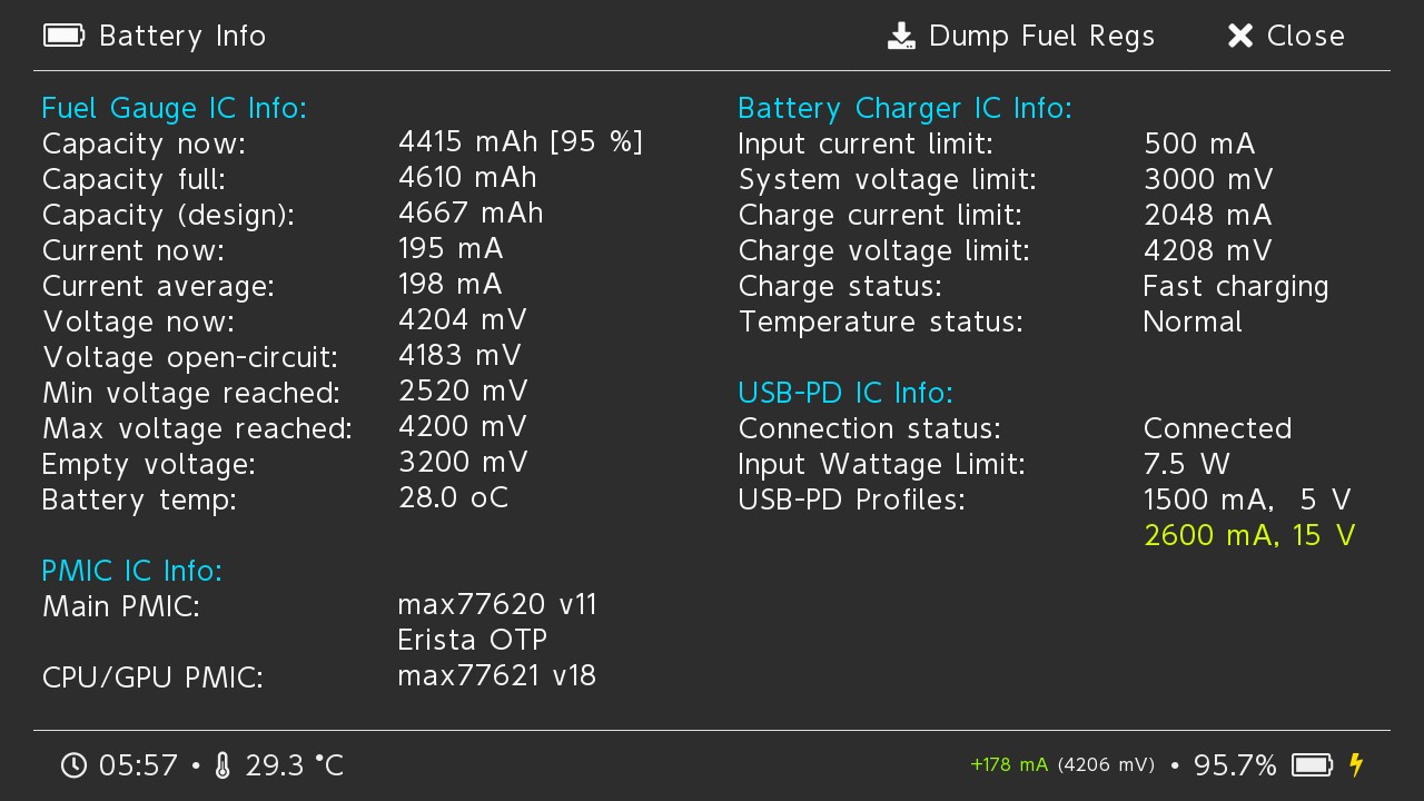

The battery issue was resolved after several charge and discharge cycles.
The SD card issue is also resolved; after checking, I found a broken pin inside the slot.

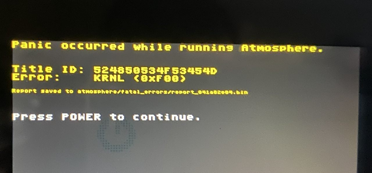

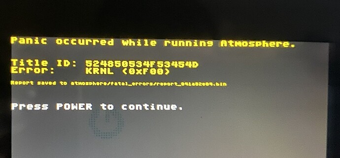

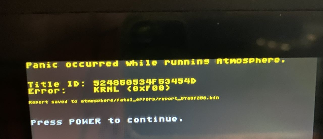

The console freezes less frequently on startup in Atmosphere Mode.
When it does it’s always on the second boot, either with an error message, the Switch logo, or a black screen.
When it starts up correctly, everything works perfectly, but waking from sleep mode always causes a freeze.
I don’t know which component is causing the problem…
