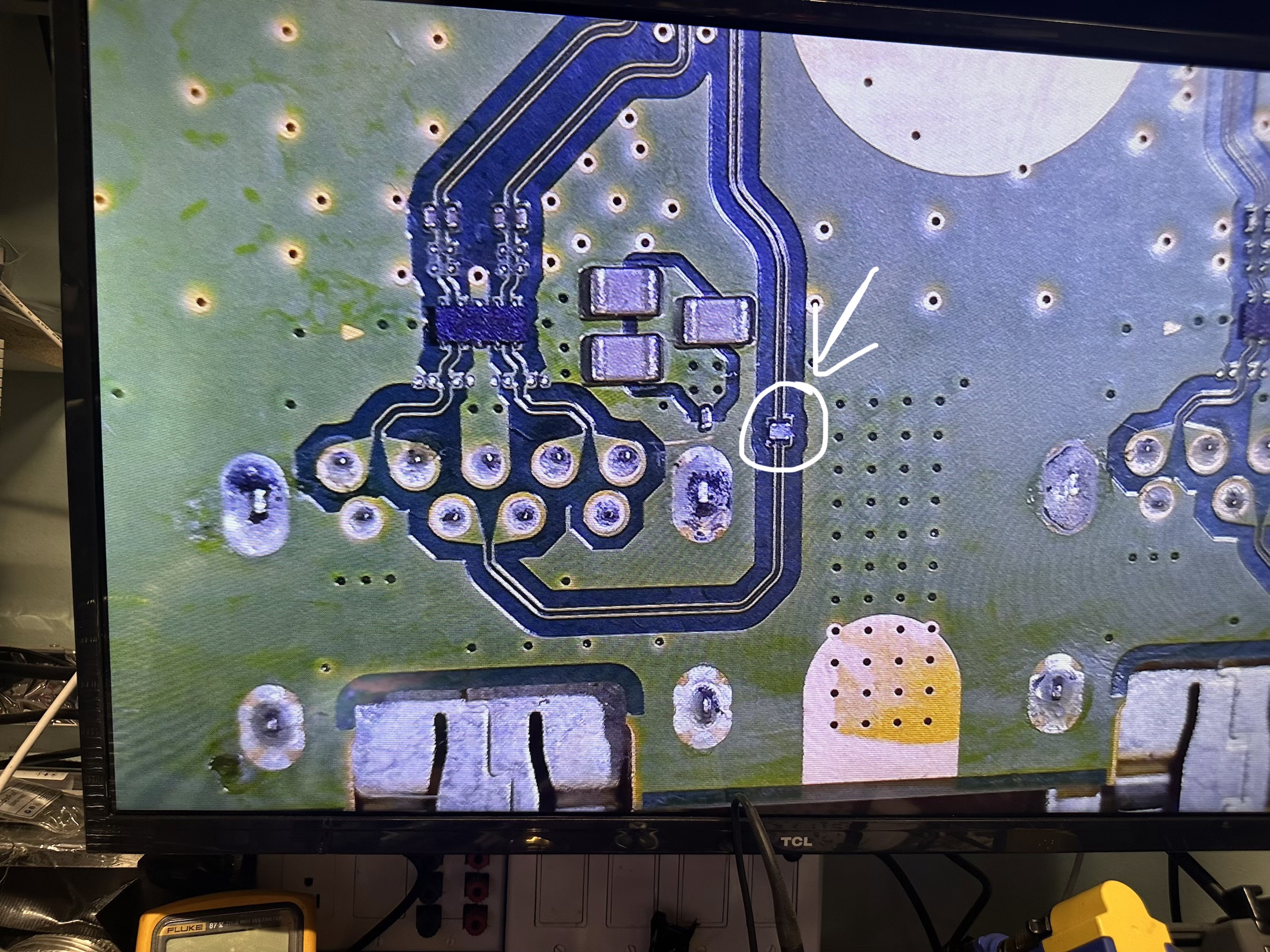

Rear Usb filter?
Located under the rear usb ports. Reads 3 ohms. I assume i could replace with single 0201 resistors if I had them lol
resistor does not provide high frequency noise suppression from the common mode/Choke filter in the circle
Appreciate the reply. I have one that was ripped off the board from a prior repair attempt. I was hoping to find a replacement.
Usb3.1 common mode choke filter
