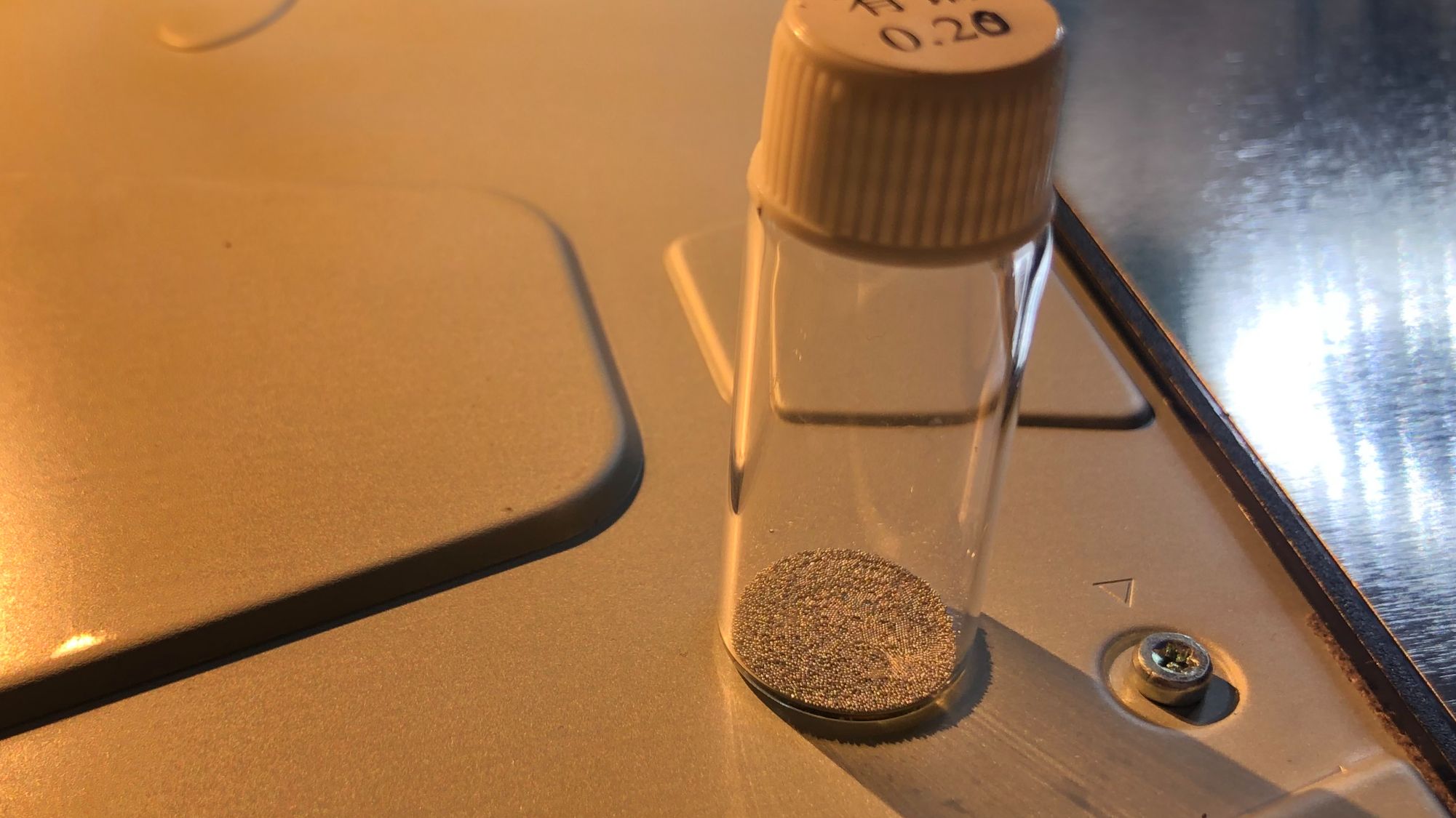

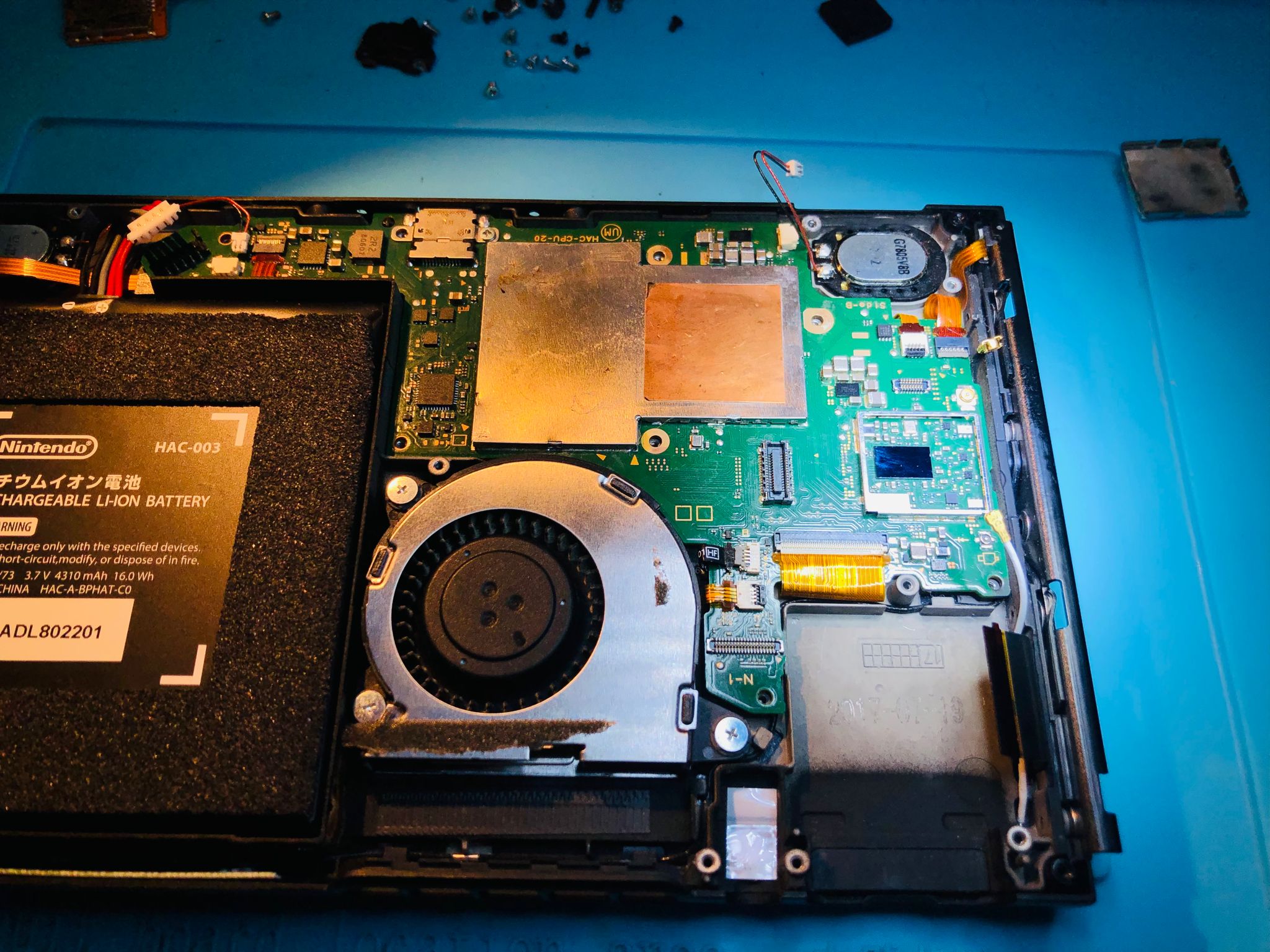

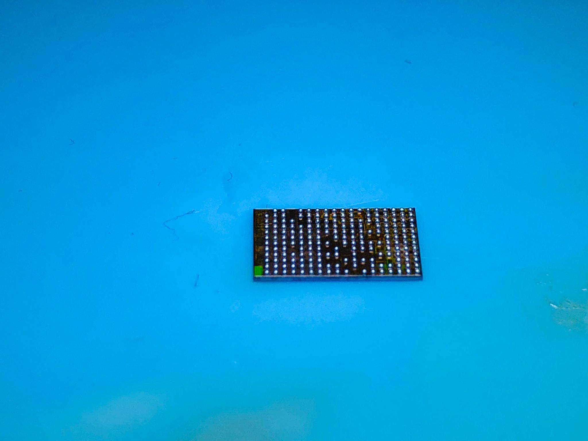

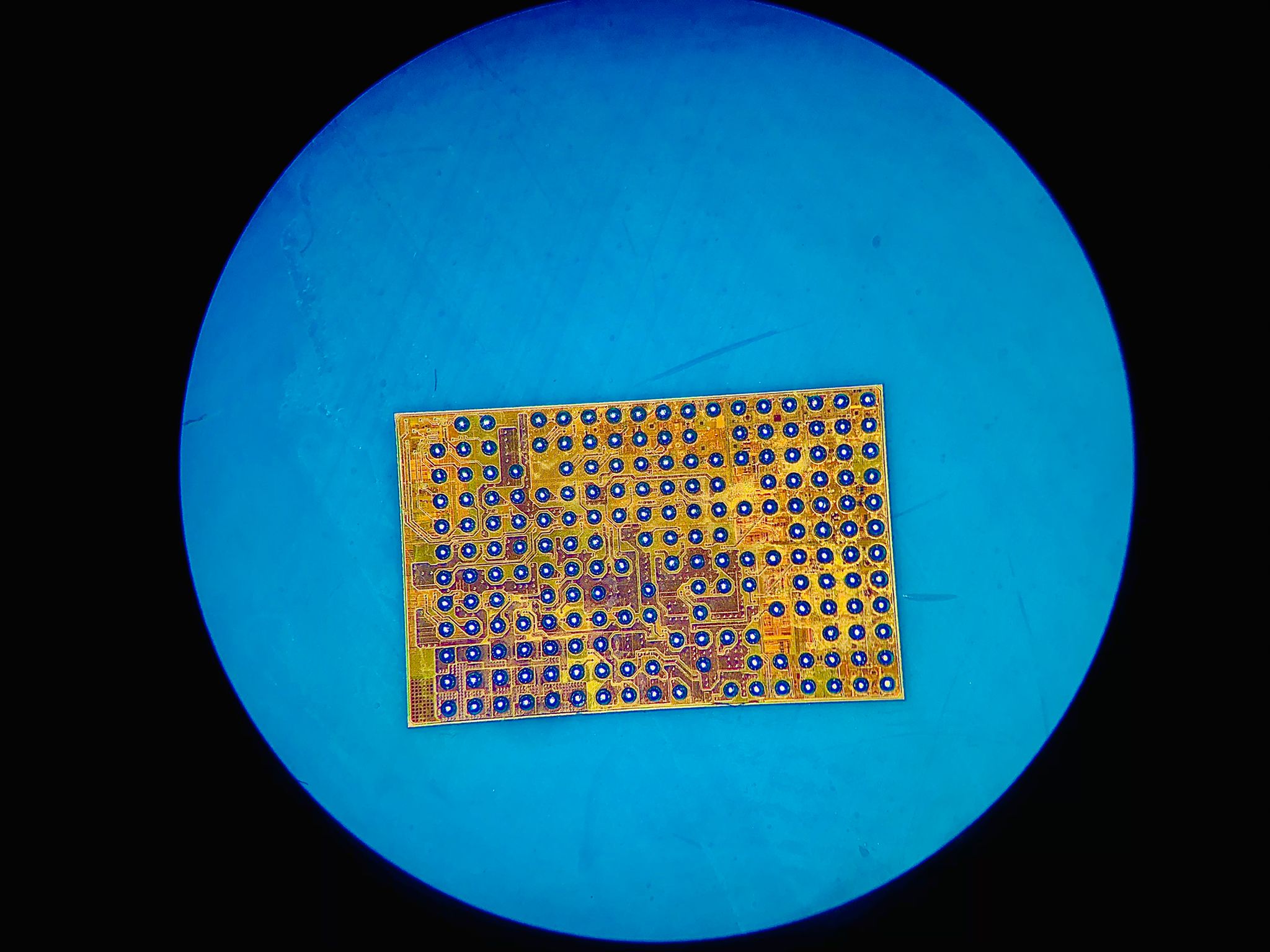

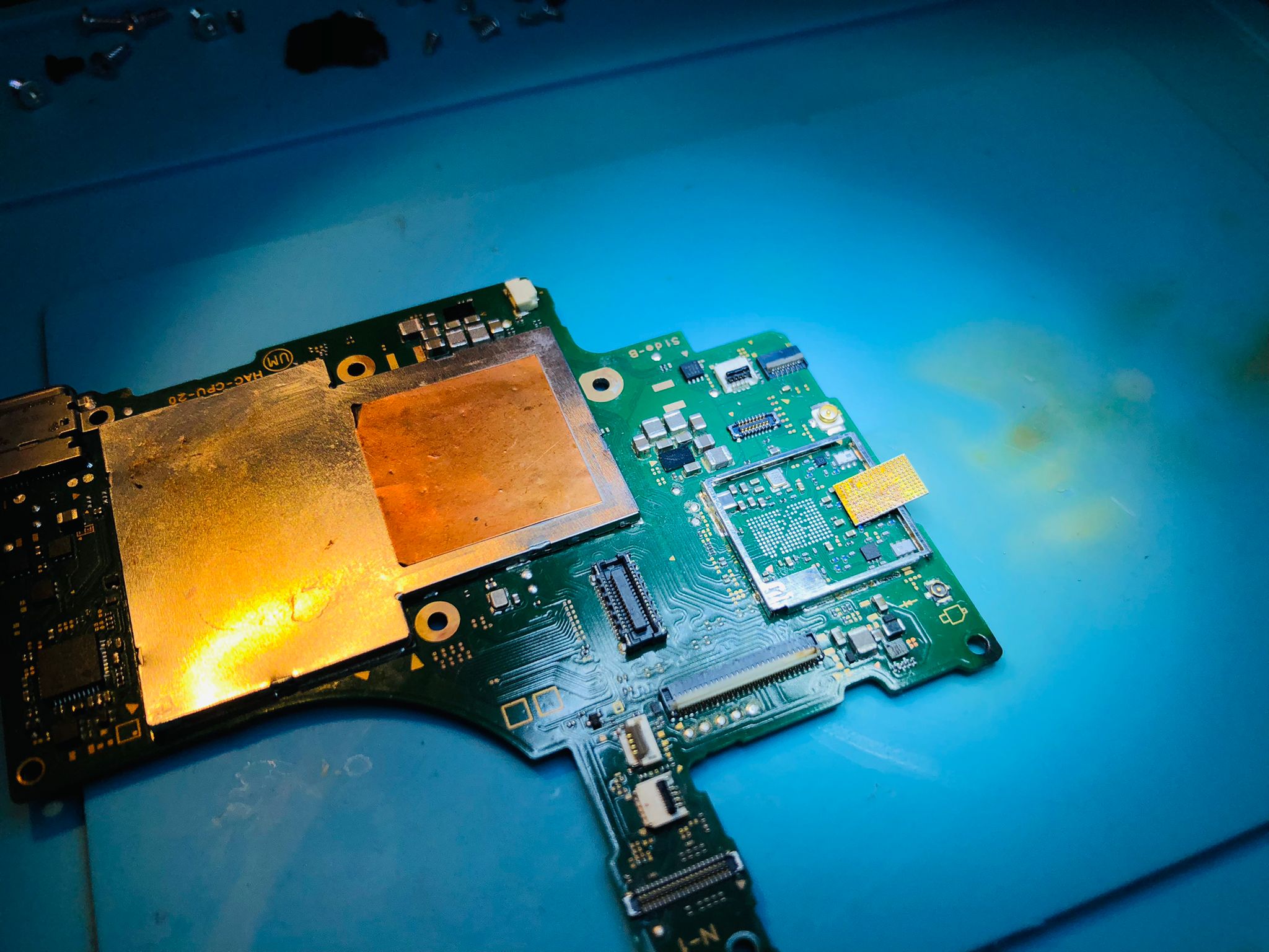

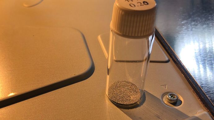

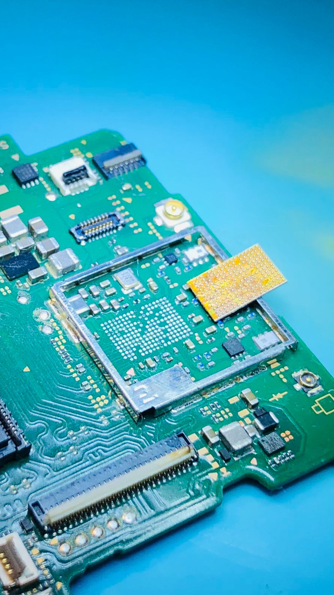

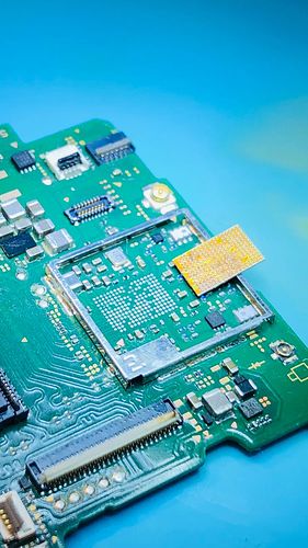

A motherboard Nintendo Switch with the Wifi chip module Broadcom BCM4356XKUBG broken. I replaced it with another from a donor logic board. I put the balls by hand one by one. I used 0.20mm balls.

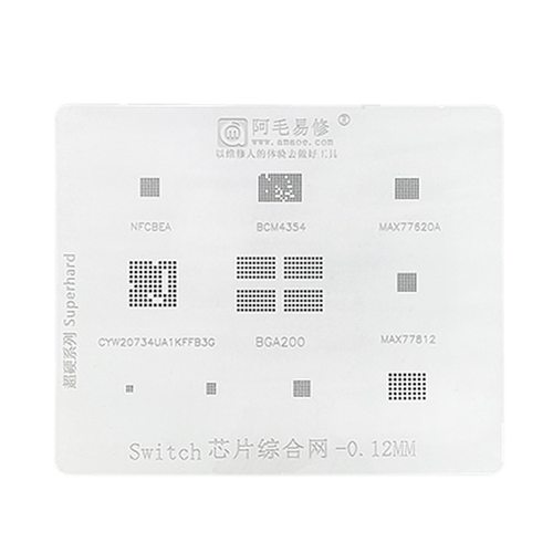

WHY not having a handy NS STENCIL?
I have but I can’t find it. I will order another.
