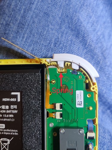

I just replaced the L stick on our dark gray Switch Lite. I followed a tear down video but I have a very tiny spring left and I am not sure where it came from. All the buttons seem to be in working order as far as I can tell.
thx
What does this spring look like? As far as I know, there are only 4 springs on the Switch Lite. 2 are cond shaped and go in the joysticks, the other two are for the L and R buttons. They go on a little peg on the button itself.
I have a pic but I can’t embed images here or post links. its 8mm long. is there a video or pic somewhere that shows where the springs go? i look at the right side without taking it apart and didn’t see any visible springs. thx
Yep, that’s it. Thank you. It was fairly easy replacing that stick and it saved me the $89 or whatever Nintendo wanted.
