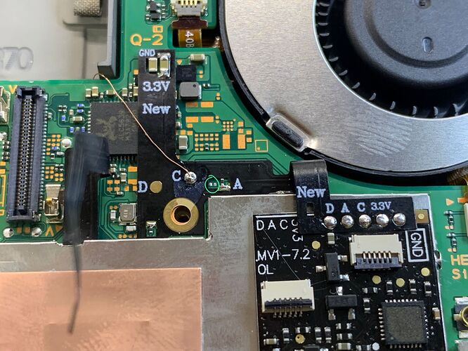

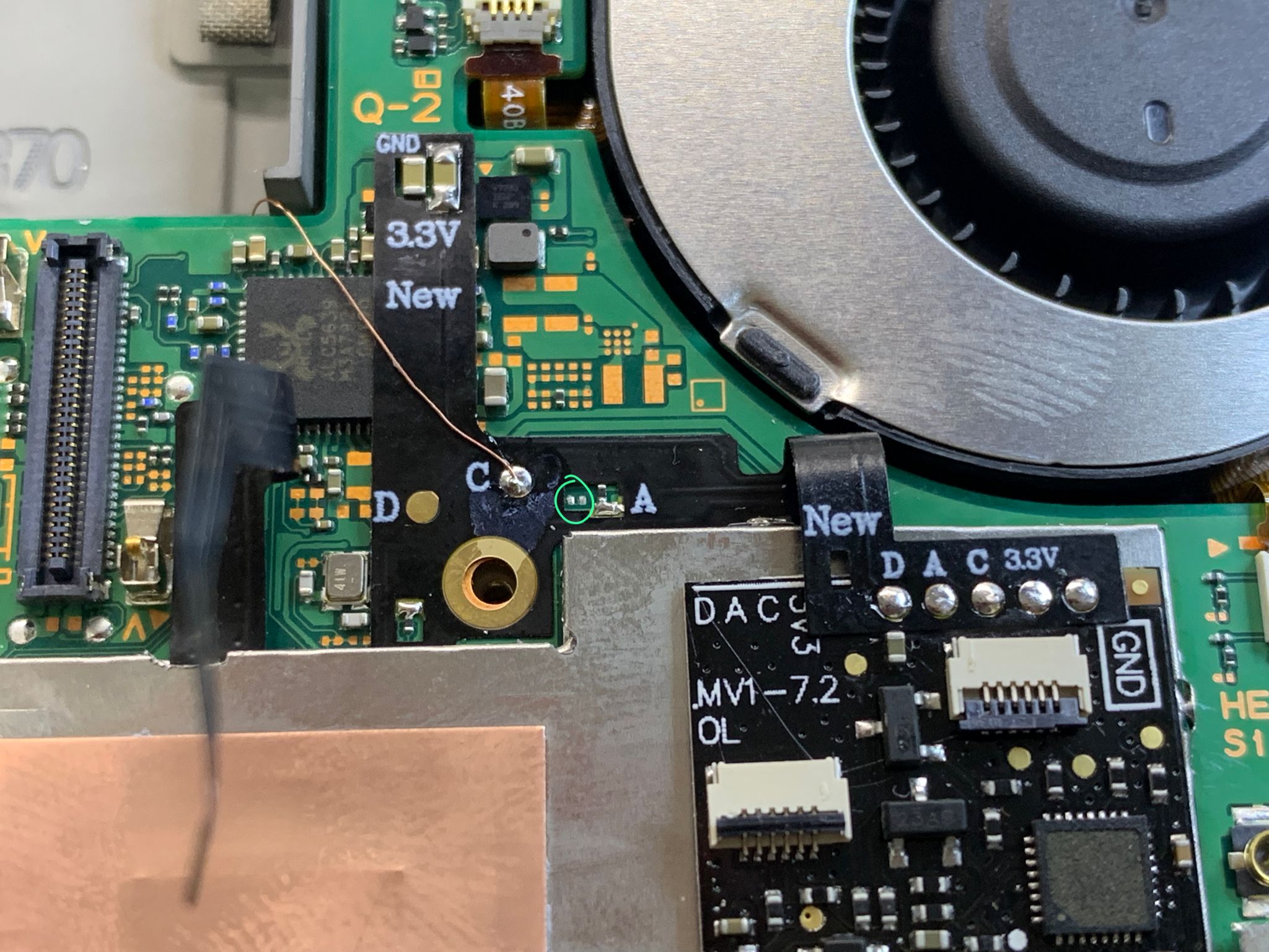

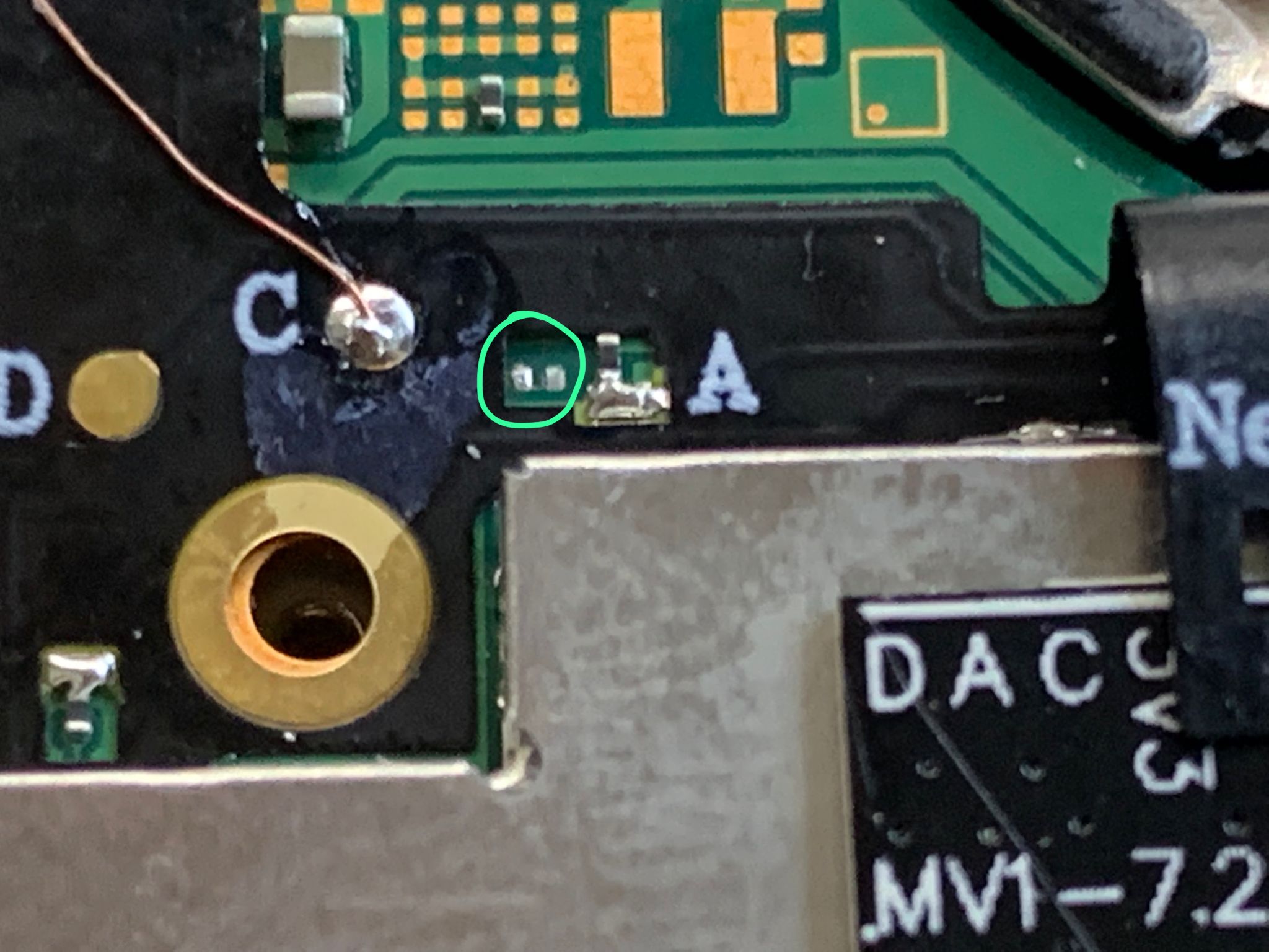

Hi guys, could someone help me with the value of this resistor, I would be very grateful.
Greetings
i was only able to measure while in circuit, so this number is most likely off, but it gave me 32.6 kohms
Missing one is 47K OHM resistor, where A point is on the 4.7k ohm
