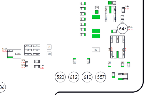

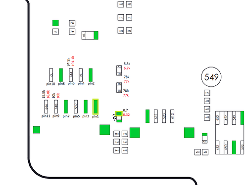

Here are my diode mode readings (no battery, no power supply, red probe on ground, black probe on the pin/pad) for the left and the right JoyCon connetor: The voltages should be like in the 3rd picture. The resistance values are from a broken Switch, so I don t know if they are ok.

(any chance you can send me full versions of the diagrams for the Joycons? You gave me the main board in the past​:grin::grin:)
Sorry, I didn t make a diode map for the JoyCon.
