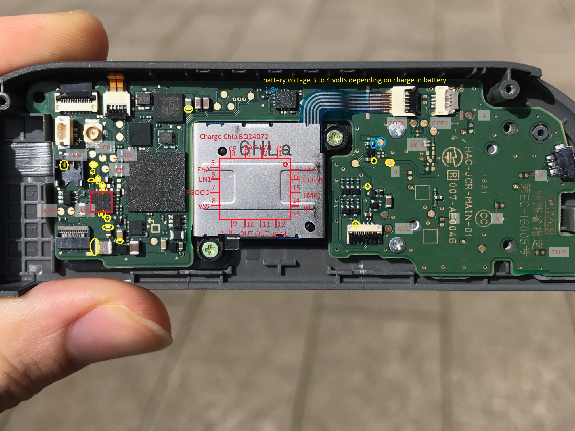

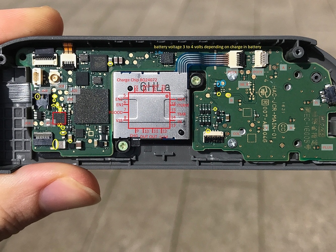

Thought I’d share this here as well. Right side joycon voltages with a battery connected. This might help other people to fault find on the joycons. This isn’t complete and is a work in progress and I’ll update it as I find more voltages.
