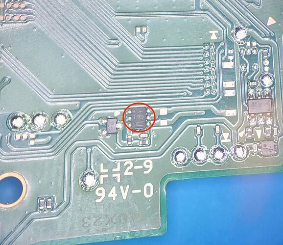

Over on the Switch repair wiki, I see an article about joy cons that won’t connect wirelessly and details a faulty capacitor surrounded by two resistors and a six pin voltage regulator. I’d post a link to the site, but it appears here I cannot…so here’s a photo.

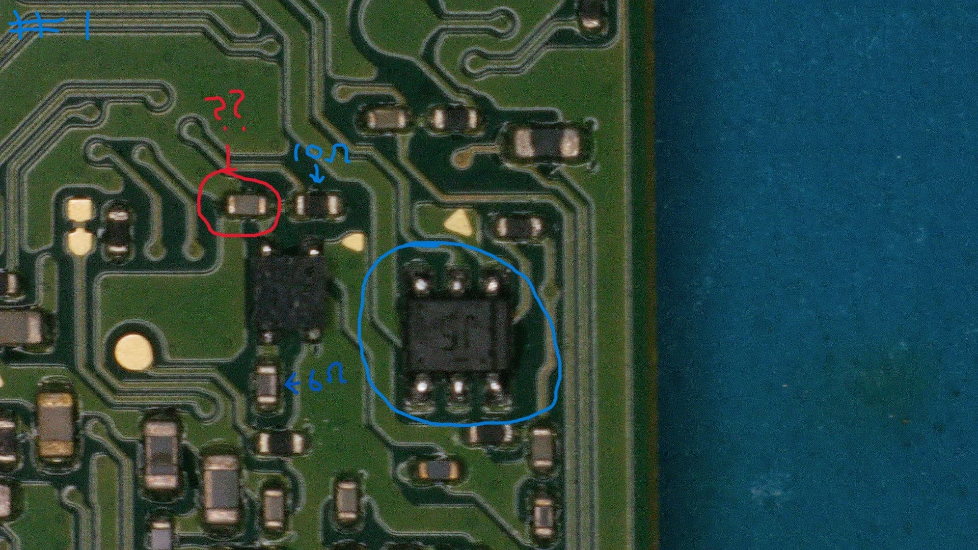

Mine looks like:

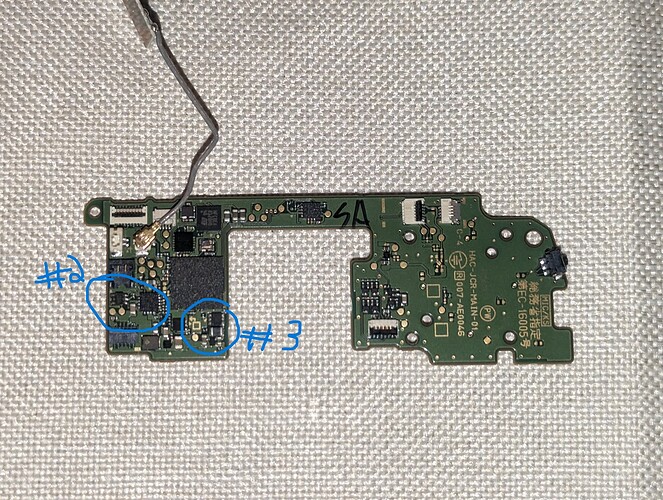

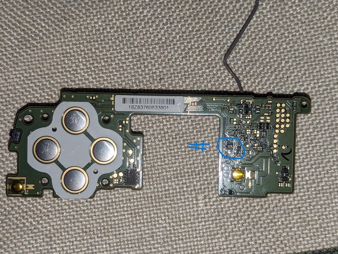

Here are a few areas of interest that look like they could match, but I have no idea.
#1 - I think this is most likely, even one of the resistors measured 10 ohms but that could just be because it’s a 10 ohm resistor. Maybe the cap circled in red is the culprit? I don’t know what its values are so I can only guess. It’s not shorted though.

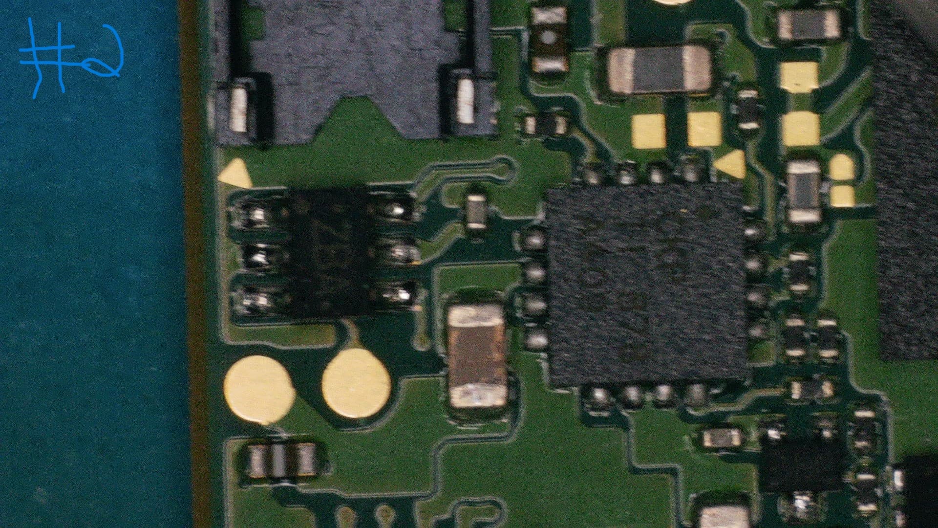

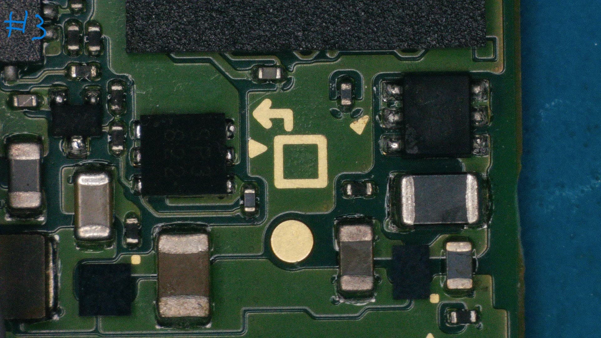

#2 and #3, I think these are less likely, but look somewhat similar.
