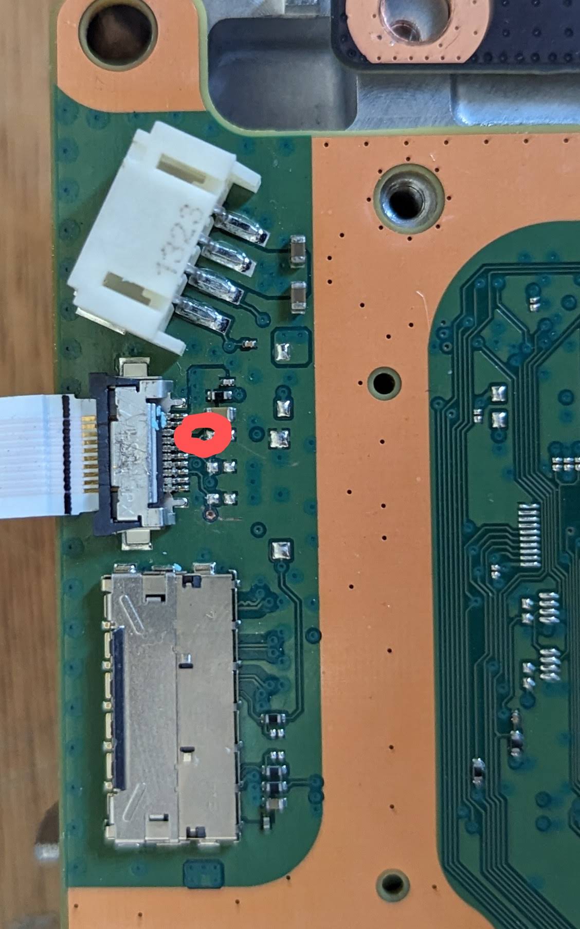

Series x which pins to bridge to power on without power button?
also how many pins does the ribbon cable have and whats the pitch? thx!
You can power on with a usb controller. Or short this pin to ground, sorry about the circle being so big, but it’s the right most thin via, going to an empty pad.
