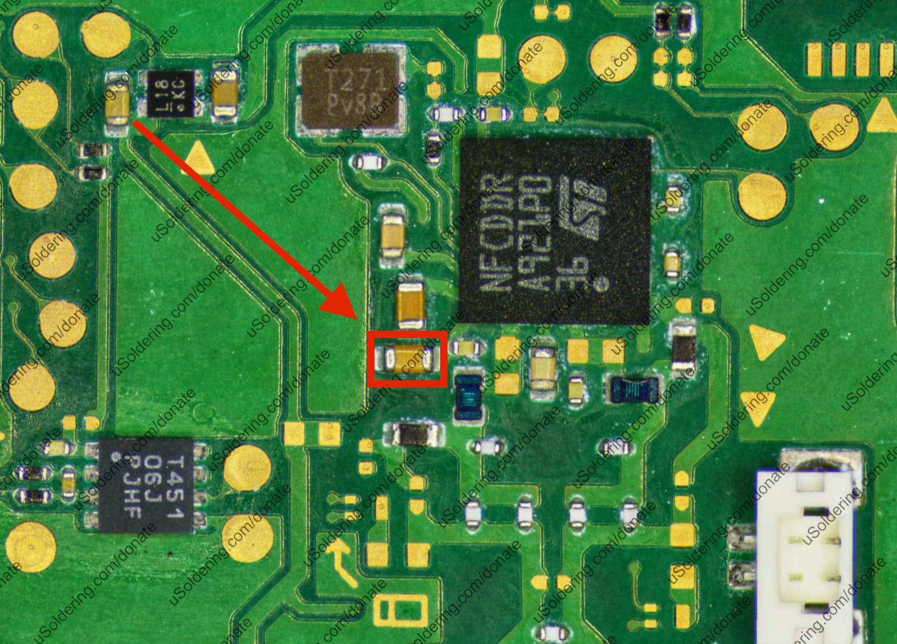

I had this Switch Lite with a non working fan. After replacing both the fan and the connector, nothing. It was weird so I decided to inject 5 volts and nothing still, which was even more weird. That’s when I found the power line was in short to ground.
A heck of a nightmare, I had to de-solder a lot of IC’s and other caps on my way to the culprit. It finally resulted on being this capacitor
imgur(dot)com/a/R2lIMBY
Could you check its value on a working unit? Or could you point me where I can find this information?
In any case, thank you for your time! Have a great one.
(Sry for the link, I can’t add images yet)
This is the capacitor I’m talking about
