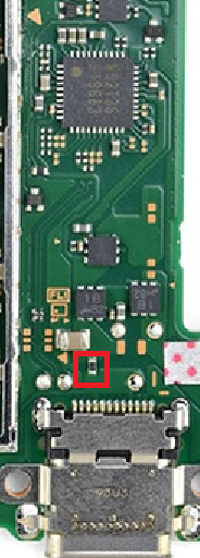

Hello I shorted this capacitor near the charging port to the metall backplate and now it wont charge, but it still turns on, what could be the problem here?
https://imgur.com/a/ZArdC0q
Maybe the fuse is blown
can you maybe send a picture of the fuse and its location
Is it possible to just make a solder joint between those?
Yes and no. Fuse places there for reasons. You should check it prior to replace it
The fuse is good, then its the charging chip.
