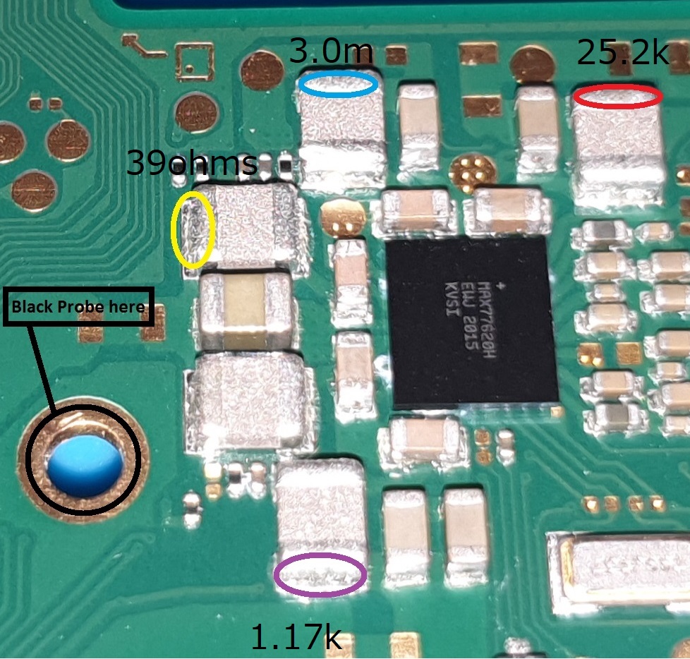

If you flip the board over you’ll see a Max IC which is the main PMIC surrounded by inductors, can you take resistance to ground on each of the inductors and let me know your results.
So red is your 1V8PDR, typically you’d expect readings of approx 10K, the resistance is made up from ram and the M92 IC, despite the fact other ICs reside on this rail the M92 and Ram on a working board are the only things that would normally have an impact on the resistance to ground (provided no other faults)
As such, I believe your have poor soldering on the M92 IC.
As I said earlier, I’d remove the M92 IC and power the board from battery only and ensure the console boots normally (even with an error code) then we’ll go from there.
