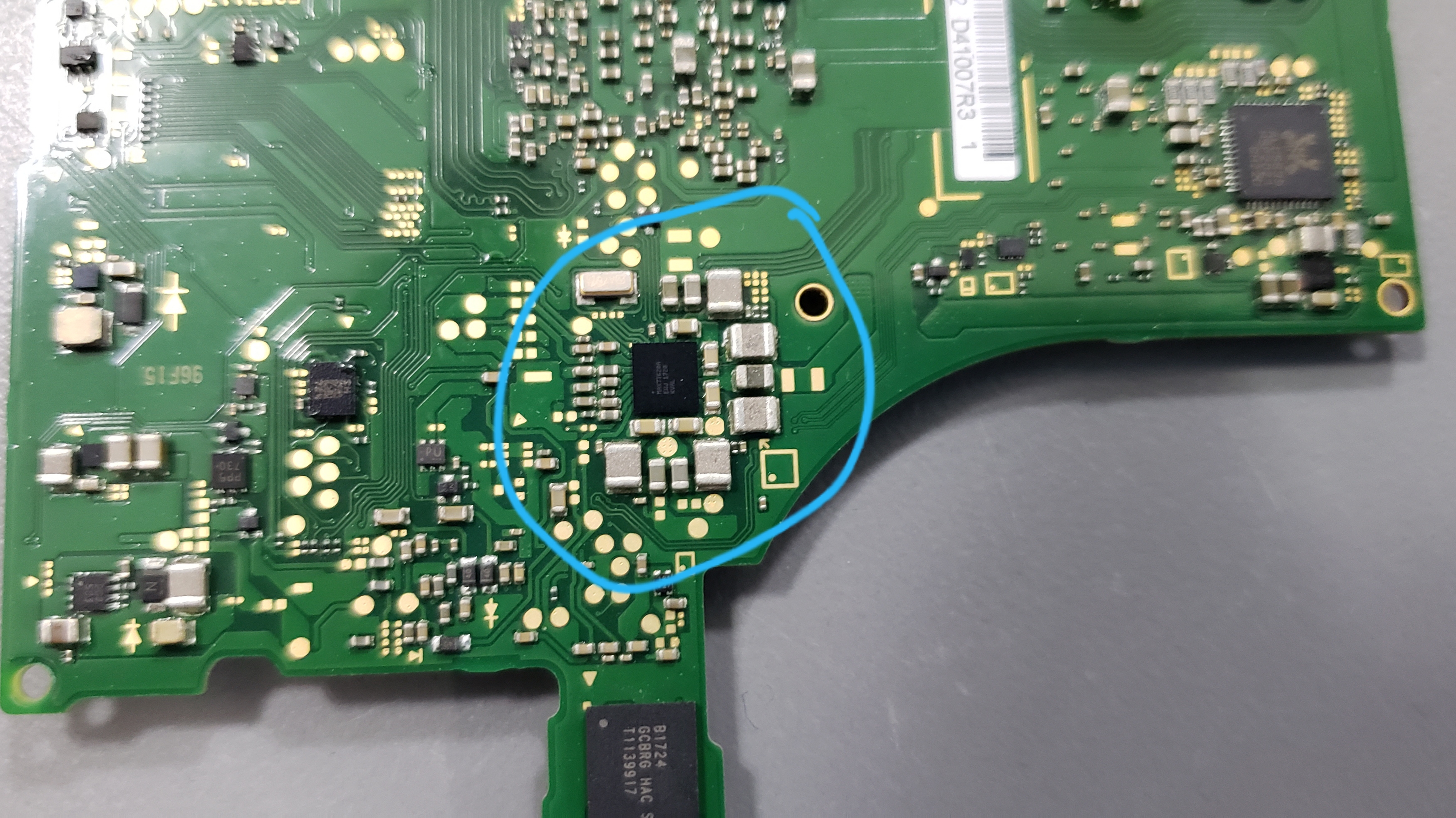

Hi there, would like to share this issue i fixed, The switch had slow menu and browsing. It also did not display when docked. After costumer left we removed it from the dock and switch totally went black, no charging no power. So after testing for shorts I came accross shorts around a chip in the back (check picture). Since its a BGA and I have no way of reballing I just made a Reflow in the chipm after the reflow thw switch it working 100% and have been playing smash bros for an hour now. So there it is folks :slight_smile:
