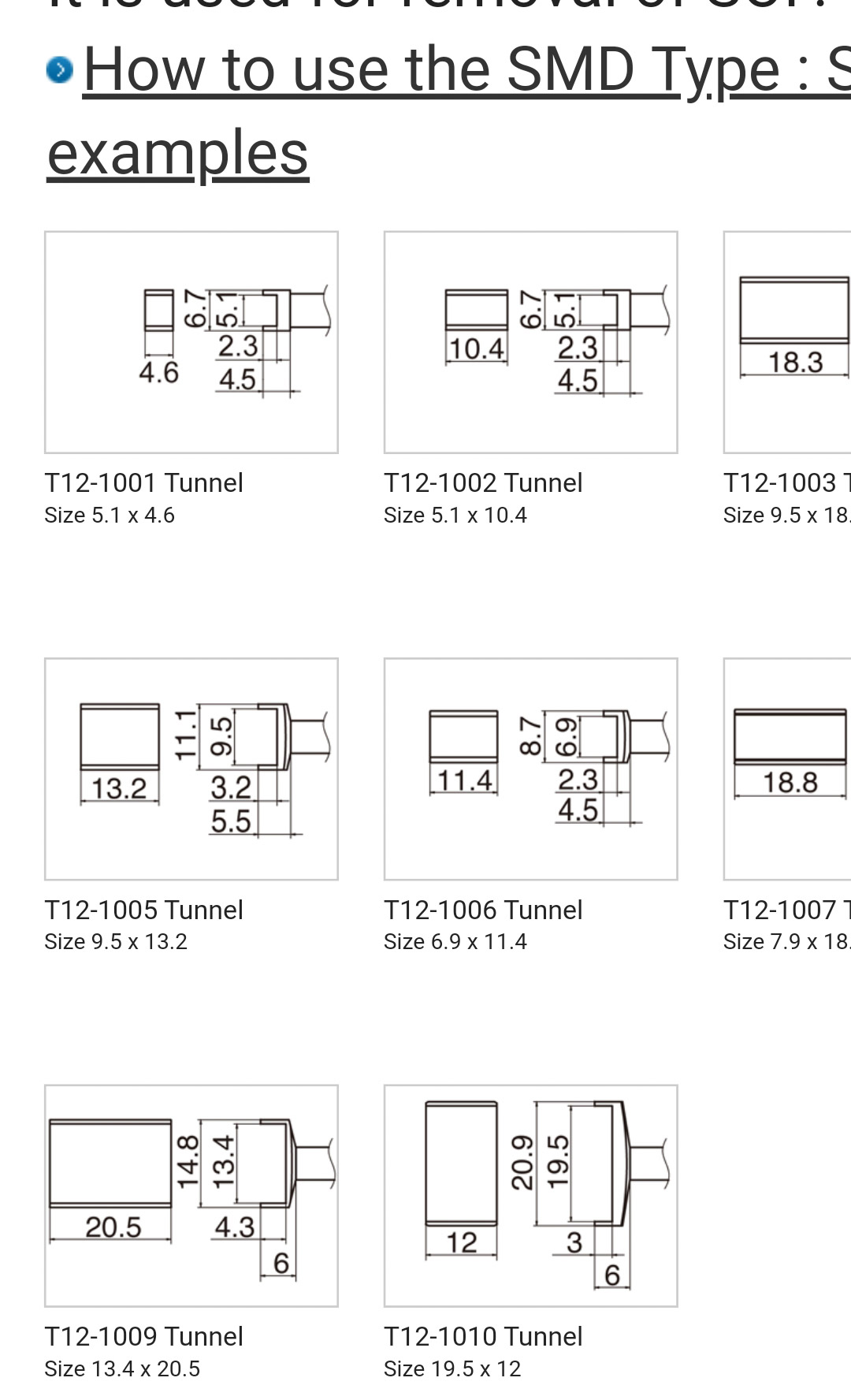

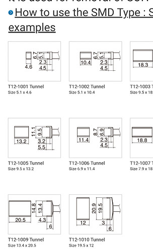

Has any used or tried these Hakko T12 tips for SMD work?

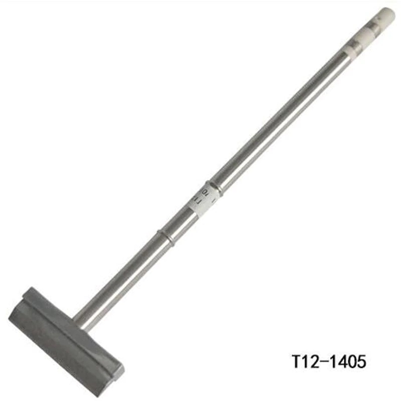

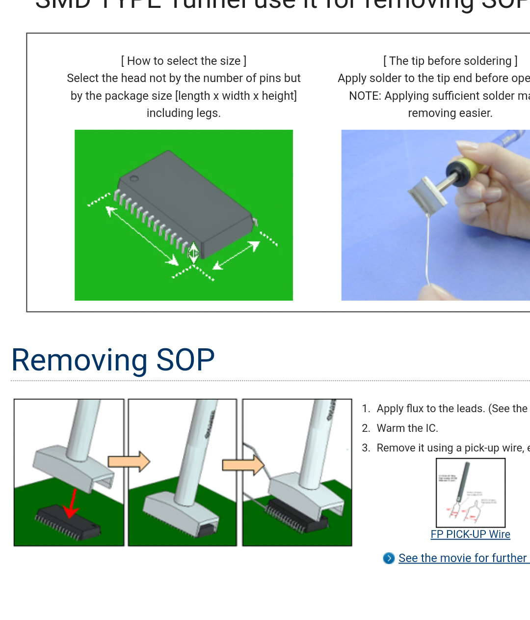

If your reffering to those large tunnel tips, I haven’t used that style myself it would seem a bit pointless to me as it seems to require both the tunnel tip and wire flipper tool… at which point you may aswell use hotair and tweezers, though i do have a single large version, like the following
tbh i don’t find them particulaly useful and barely use it… you would use this style for cleaning the pads of large BGA, but just as doable with a standard chisel tip etc
