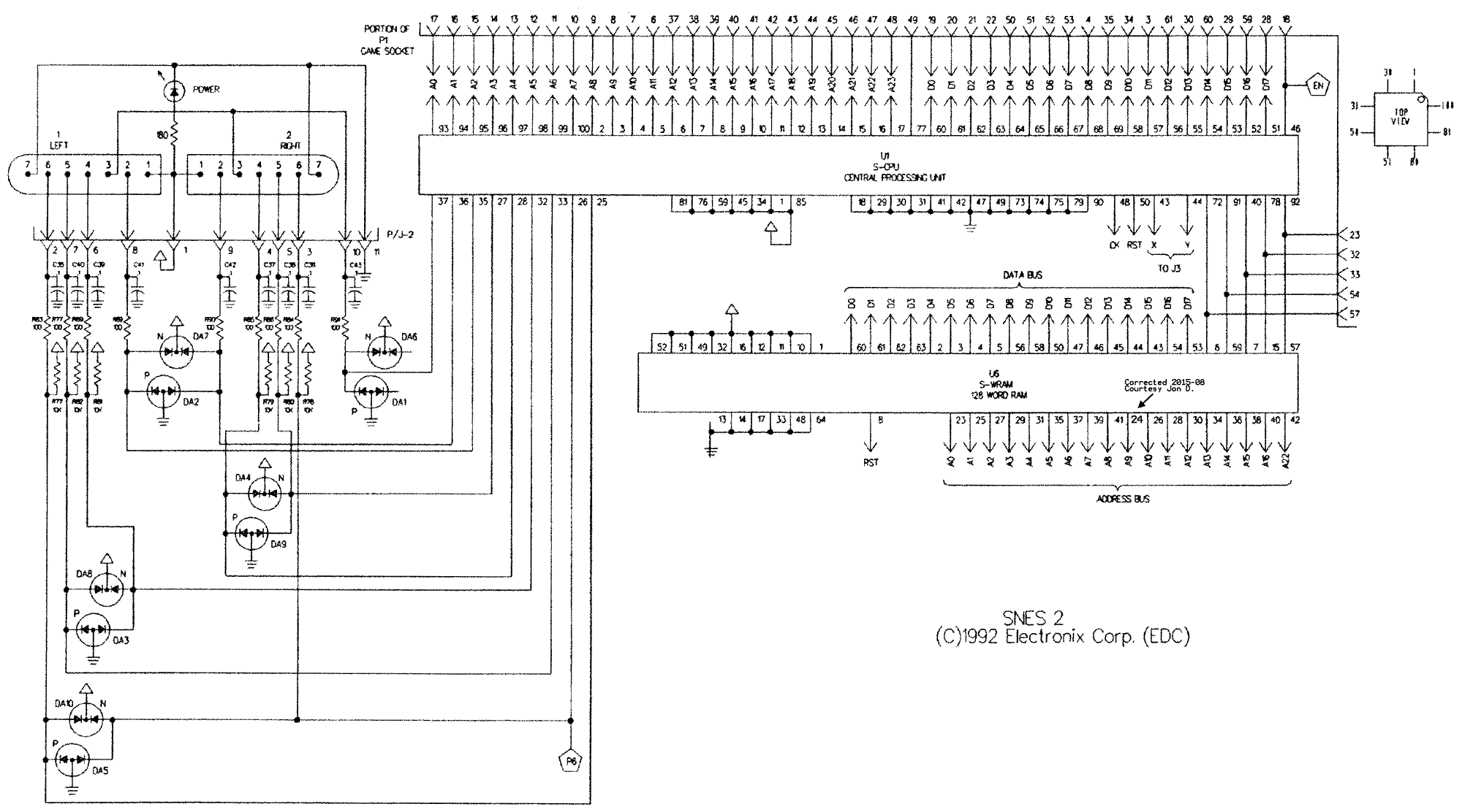

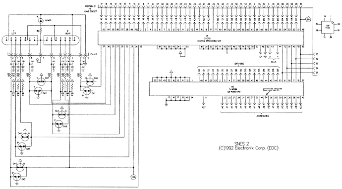

afaict the port lines CLK, latch, serial etc all go directly to the CPU, so unless something is dragging down 5V rail used on the port or there is a passive which has failed on the lines mentioned then it would point to a CPU issue.
Have you verified your getting 5V on the ports circuit board?
here is a basic pinout
There is also detailed schematics avaliable, and there may also be boardviews too
