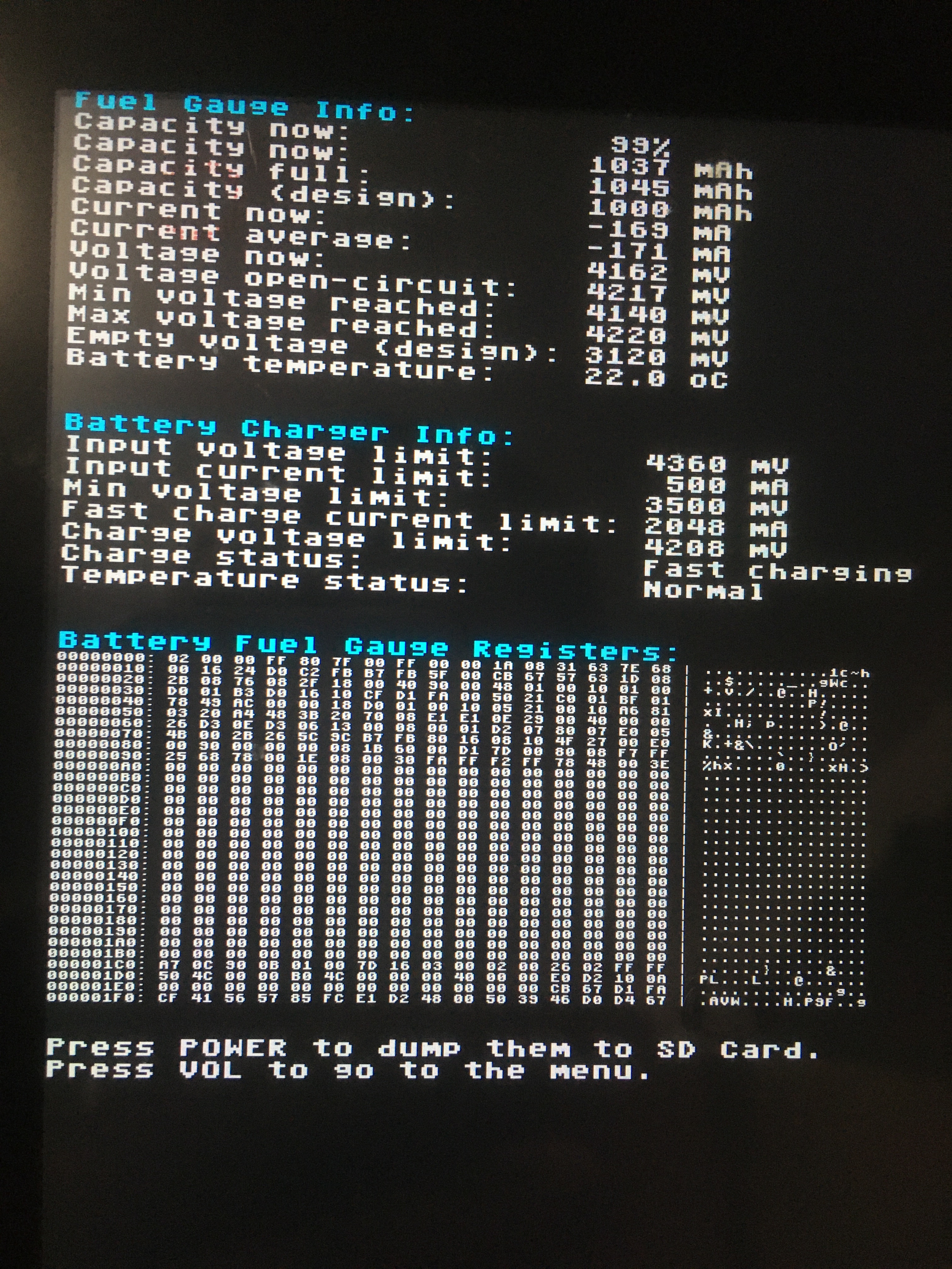

how do you test the fuelgauge?

ill check the rails and redo the bq

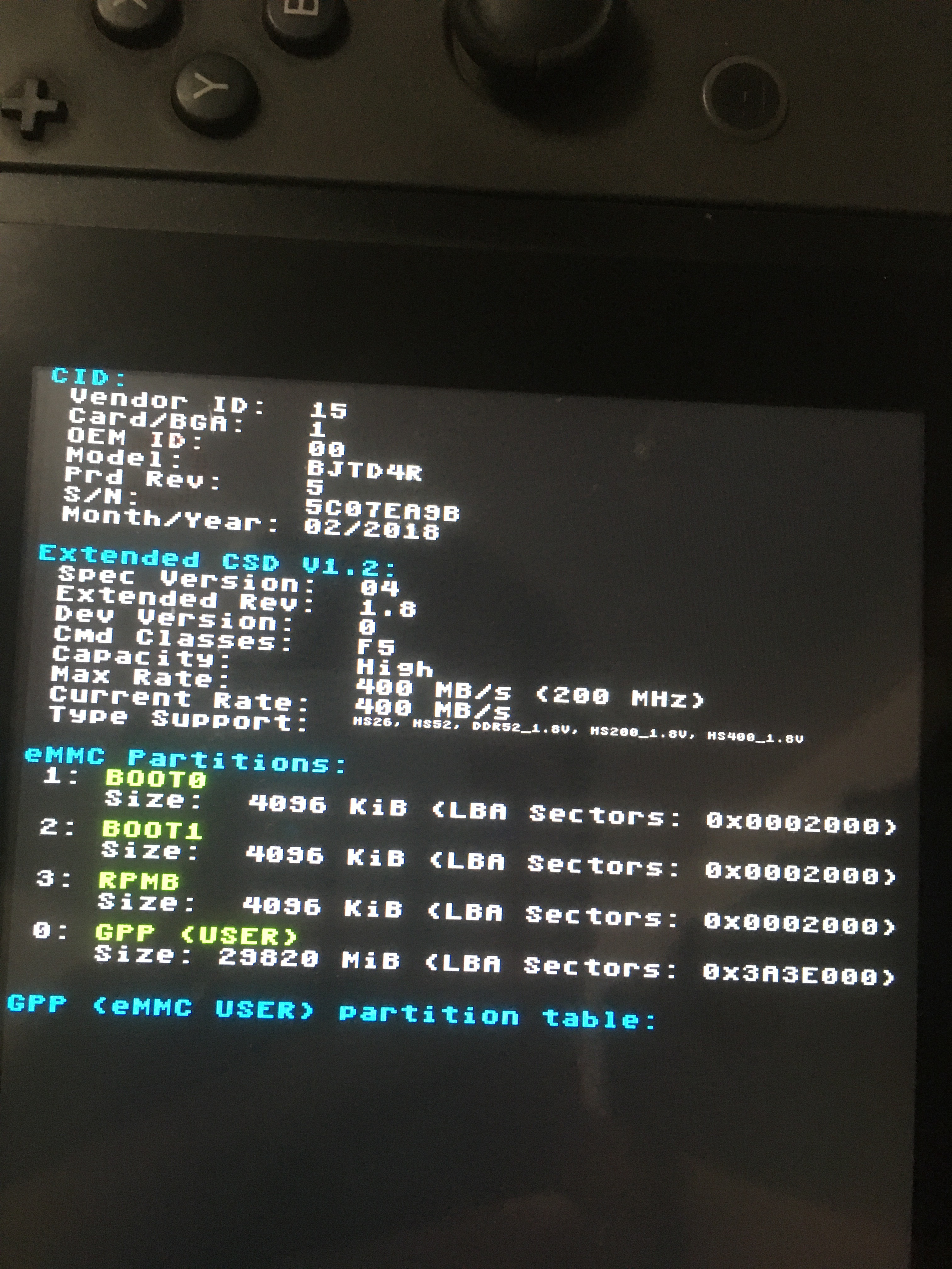

tried 5.1 doesnt work, mounted sd card on another switch and it works used another micro sd card reader and verified that one works. In the text version of hekate when I mount the sd it freezes. In tegra explorer if I mount the microsd it freezes the console.pins look ok under the microscope for the microsd card reader port. also in tegra explorer if I try to explore emmc it freezes the console and the battery needs to be pulled
