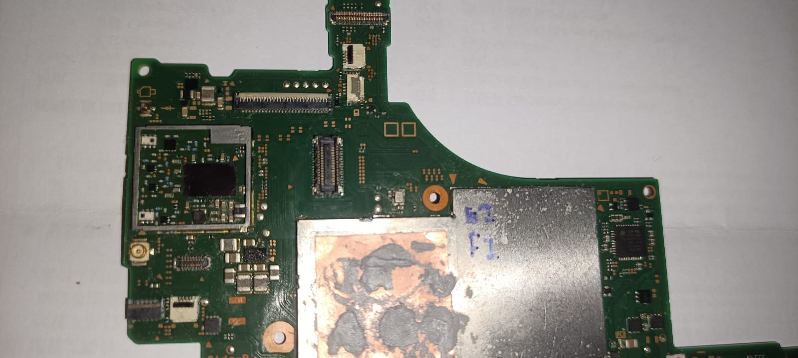

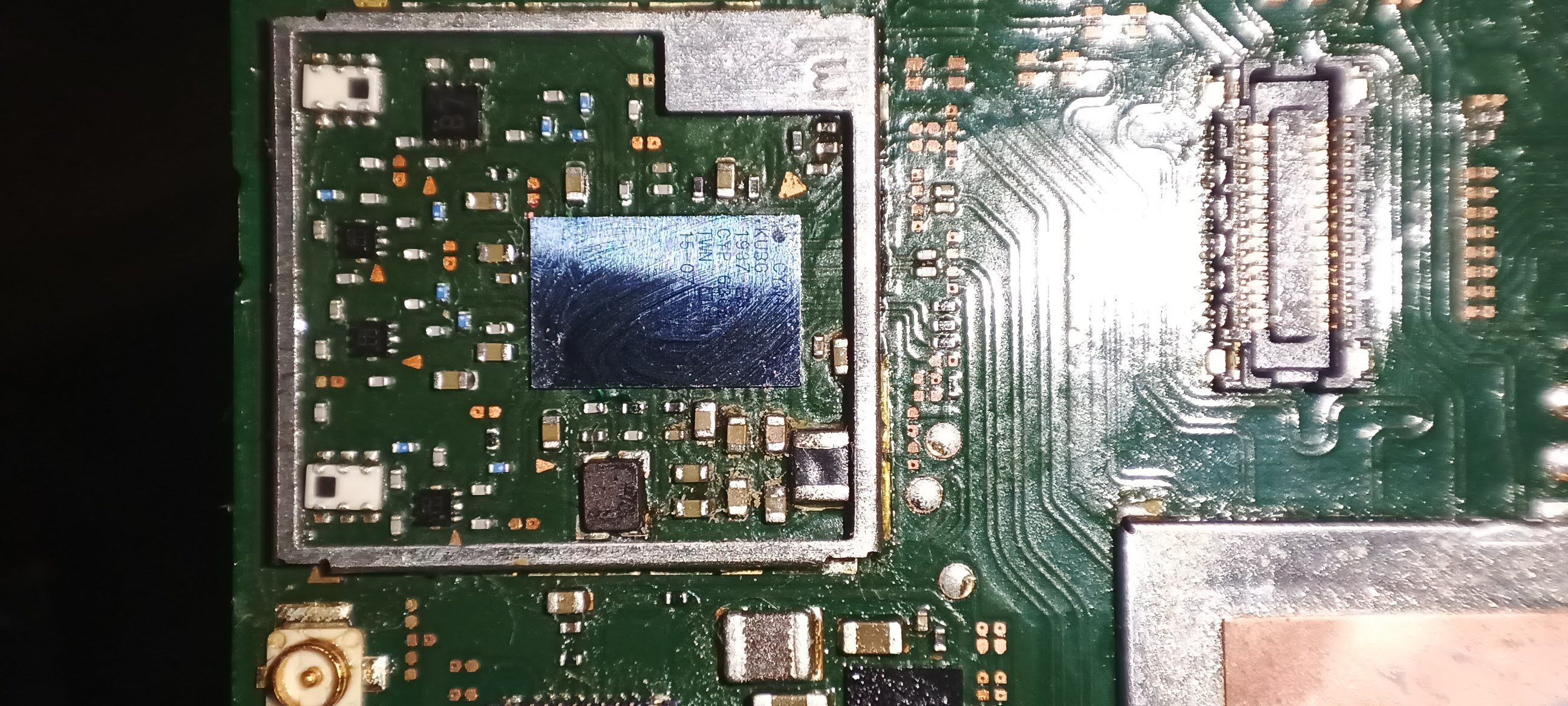

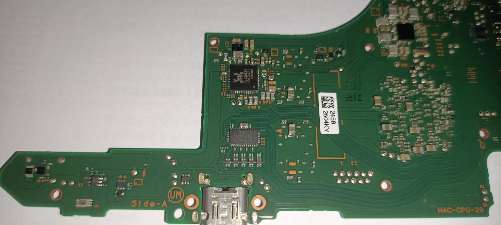

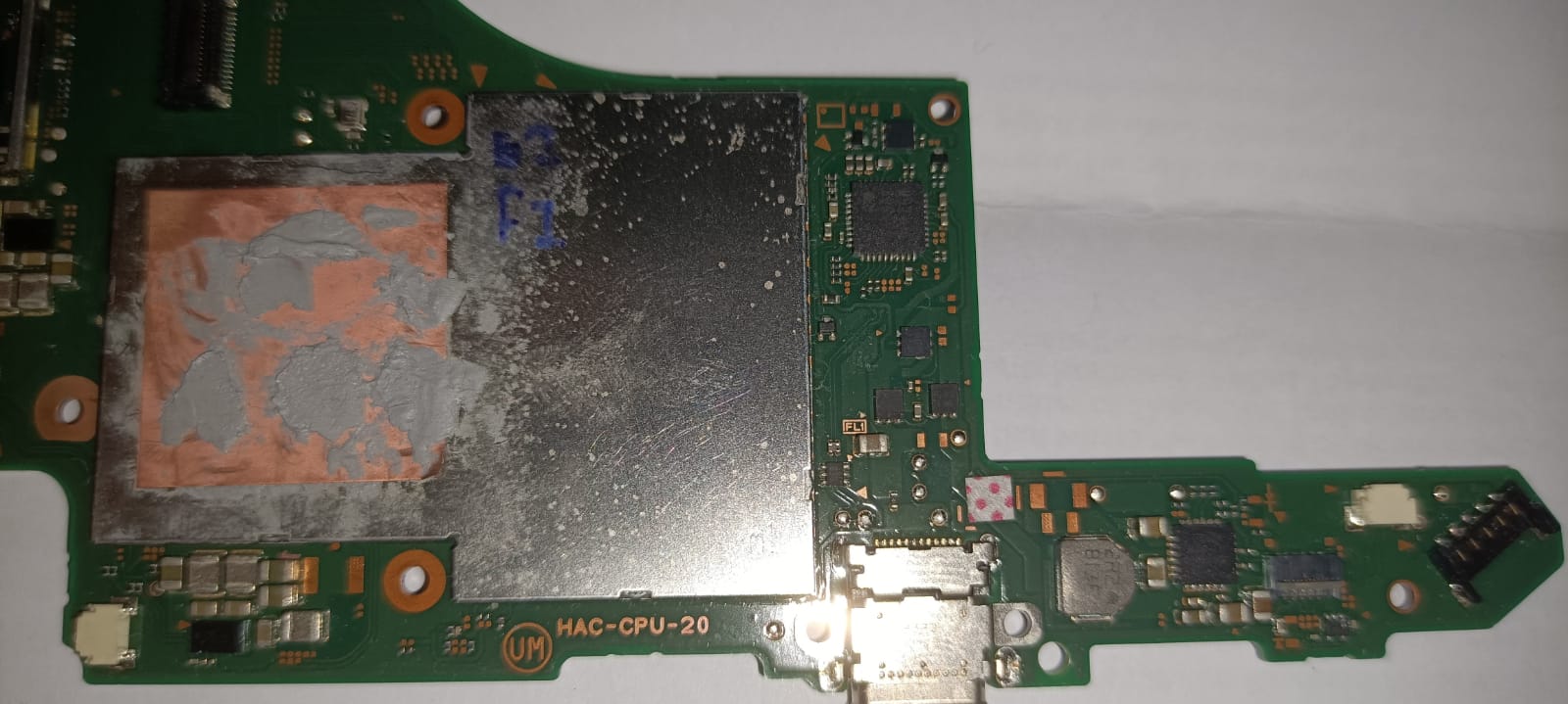

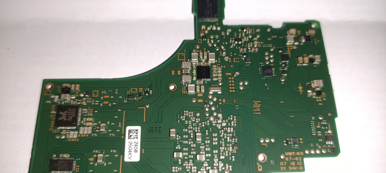

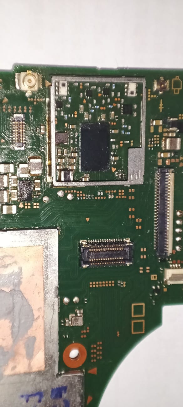

Can you take a hi res photo of the board front and back with the EMMC module removed so I can inspect.
bluetooth and wifi is ok once i can boot normally and play online game
Sorry I can’t really make anything out from those images, it just breaks down when I zoom in.
