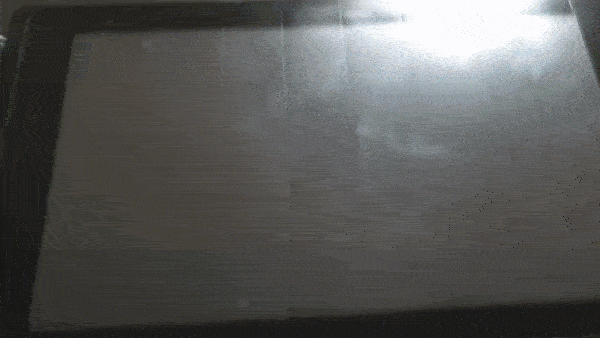

here is shown how it behaves
off_on

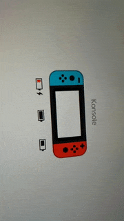

later when its on the charger it stayed on. When i had a look in the controller menu, i have seen this…
ezgif-4-85819207dd
I found a right Joy-Con rail where the contacts look like after a battery acid accident. Switched the rial to a new one and it dissapeared for the right one. After switching the left Joy-Con to a knowen good, it stopped (the fraking out battery indicators) and the console stayed on.
Tried to reboot to OFW and it worked. At the moment 10 out of 10 boots to OFW worked, so it seems it was the coroded rail and a defective Joy-Con.
Btw. this freaking out battery icon for the left Joy-Con is happening on a good switch, too. So definitly somethings wrong with it.
