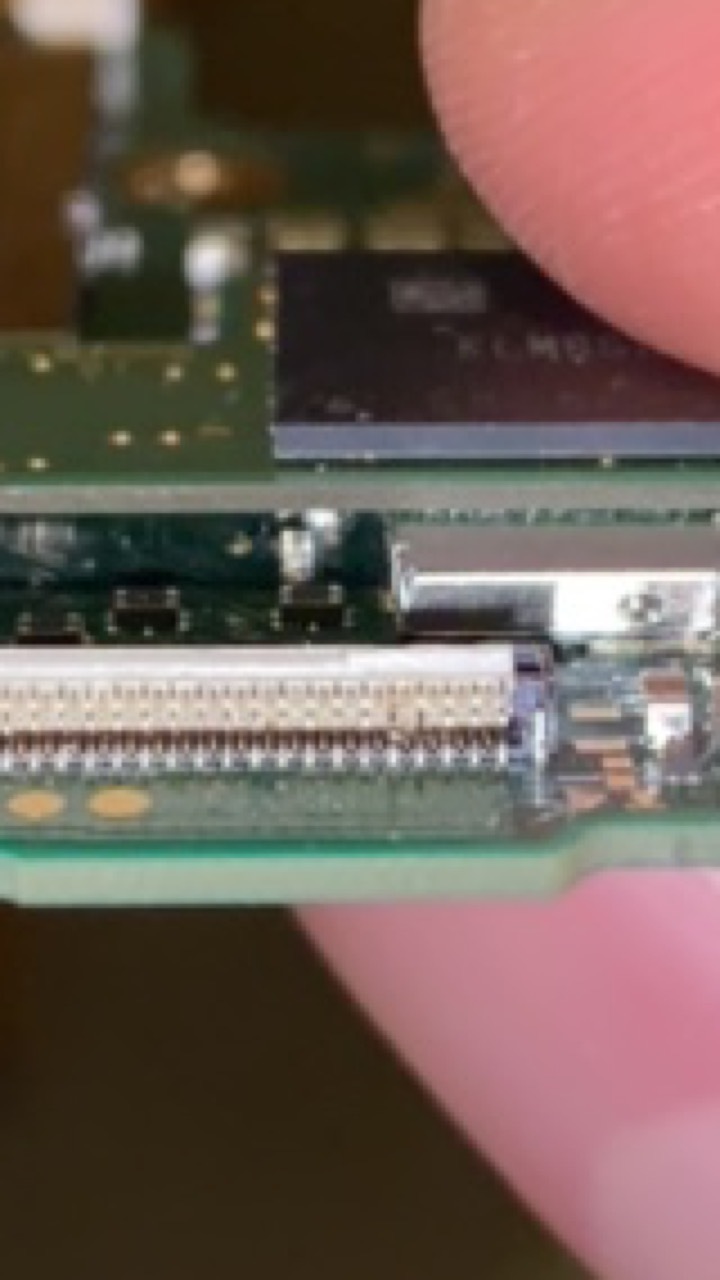

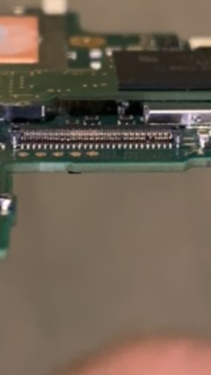

After reading on this forum, I decided to look at the lcd connector, I do not have a microscope so o have used my camera zoom, in one photo I have removed the “flip lock” from the connector, from what I can see, I have a few bent connectors!
I have replaced this type before so I will give it a go, hopefully nothing else is damaged from a short from these pins. I guess this does explain why the switch works docked on the tv.
