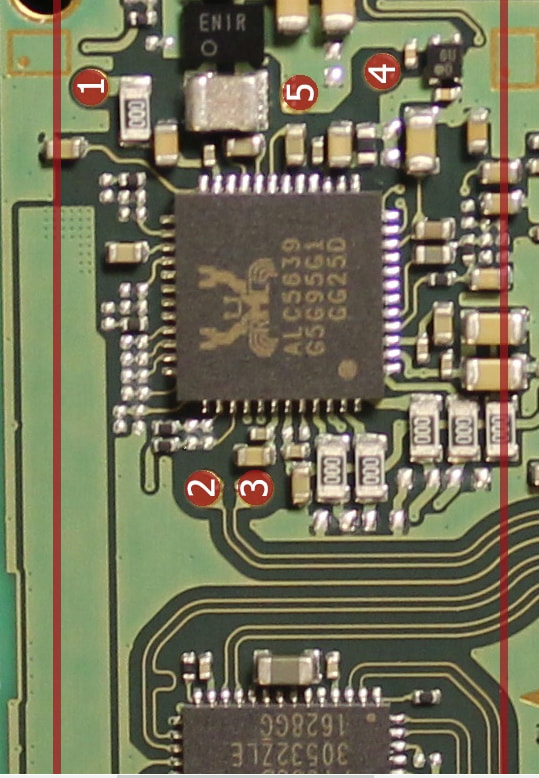

I measured points 2 and 3 in Diode mode and found no reading.

check your d+ &d- diode measure on usb port if they OL 5v charges uses those 2 dataline where PD charging uses CC datalines
Hello,
If i’m right, it’s Pin 6 and 7. I find OL in diode mode.
OK, measure diode reading on the test point 2 and 3 from the picture you shown from post, if they also OL, yoiu have a broken d+ d- circuit on CPU
I do that before and i have OL too. Sometimes, i have 0.xx but just for one second.
If I understand correctly, there’s nothing I can do?

not 100% sure if dock model would work without d+ d- but yea, not much you can do with that and no worth to reball CPU just for those
