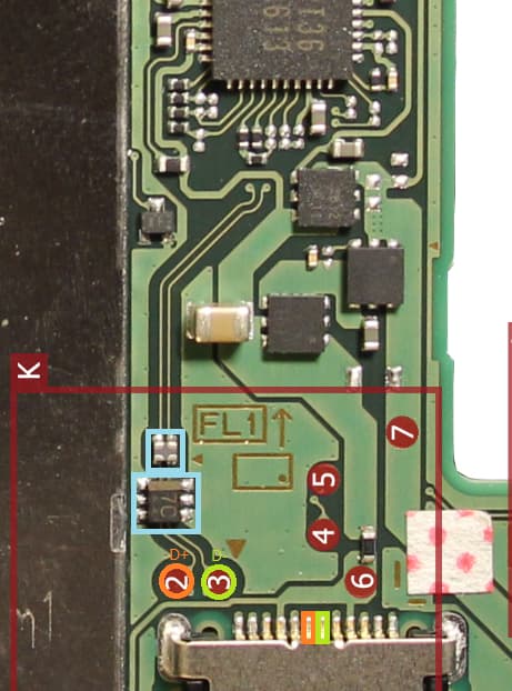

Trying to fix my nephews Switch because he busted up the charging port, and it charges but super slowly. I had replaced the port. When I hook it up to my PC, Windows says code 43 descriptor request failed. I checked where all the lines go to and they all seem fine. The M92T36 doesn’t seem to have any shorts. Over night it got 15% increase in charge. I also can’t get it into RCM mode, because code 43. Any ideas of what could be wrong? Maybe it’s the D- D+ lines? I have no idea where those lines eventually go to.
In diode mode 2 and 3 show a little over 800 while one wire is on a ground. I decided to try changing the M92 chip, because I’ve read that when people screw up the power connector it’s common for this chip to fail, even though I tested no shorts. Now it doesn’t even charge, and the VBUS test point that usually shows 5V is not showing anything. 5V goes past the fuse but beyond that I have no idea why it cuts off. I got the M92 from Amazon. I think I put it on correctly.
