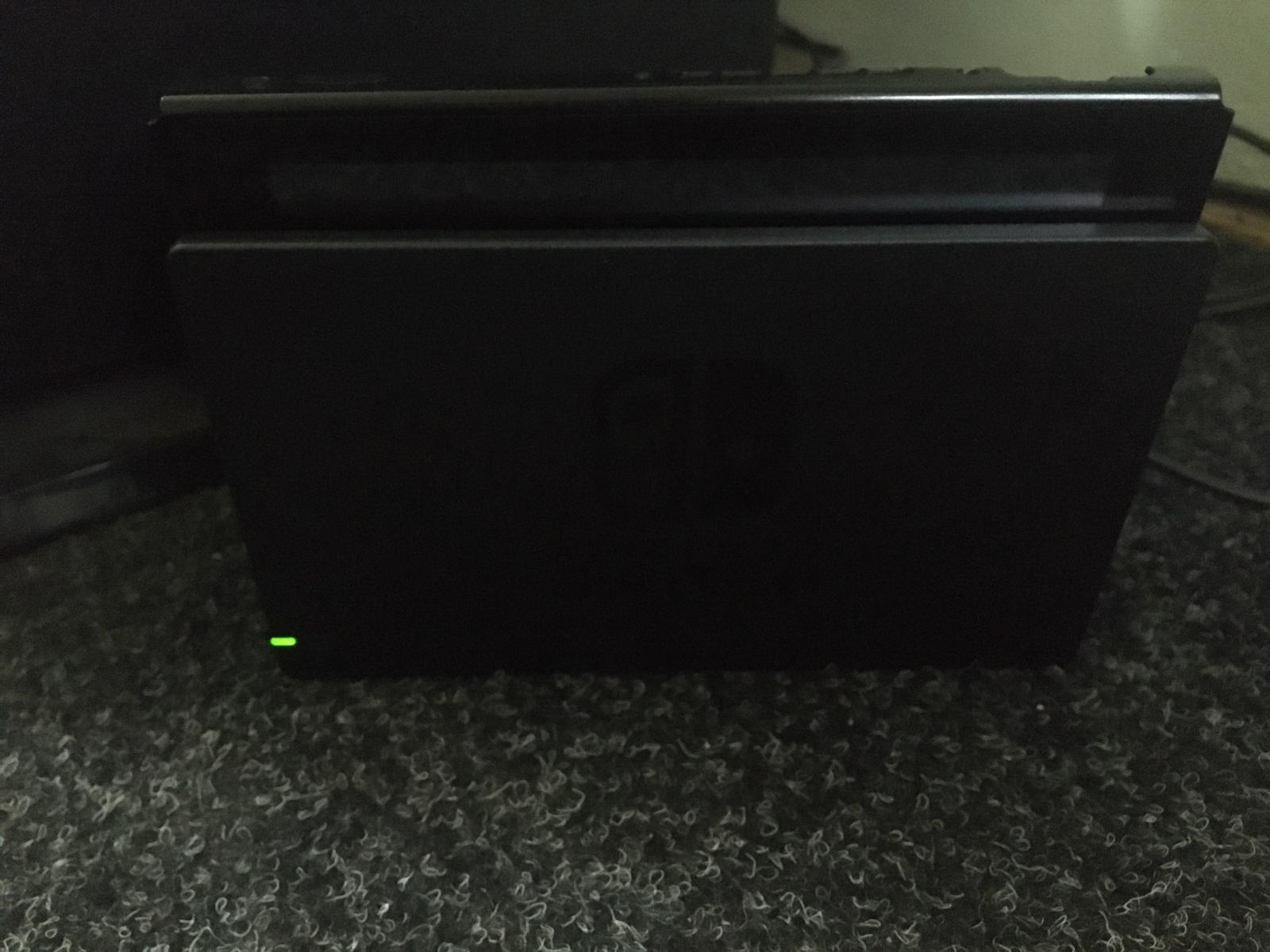

Hey guys, I decided to try my hand at repairing a few docks. I’ve had some success but one has me stumped. Basically, with no other cords attached, as soon as you apply a Nintendo official power cable to the dock the LED starts to blink almost right away. Like I said, no switched docked and absolutely no other cables. I inspected the board and everything looks okay. All the ports look good. Nothing is shorting that I can find yet… Any chance someone had a suggestion?

I guess we can rule out a faulty Switch.
Yep definitely it should only flash green if a faulty switch is docked in it and since nothing is docked well that definitely means it’s faulty

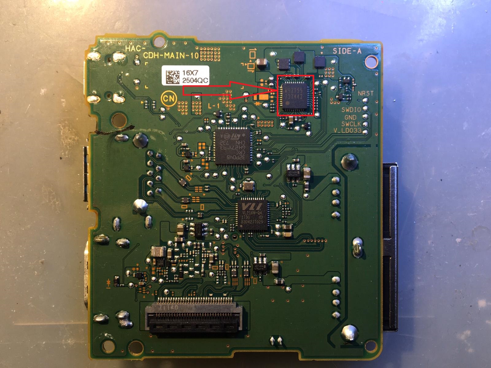

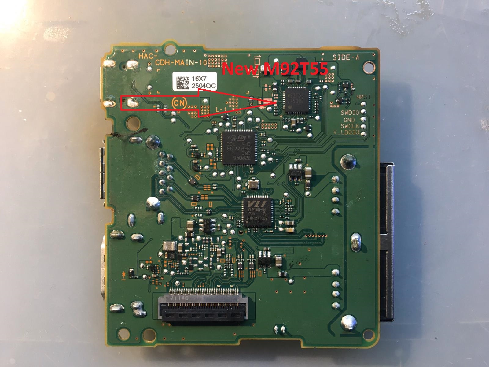

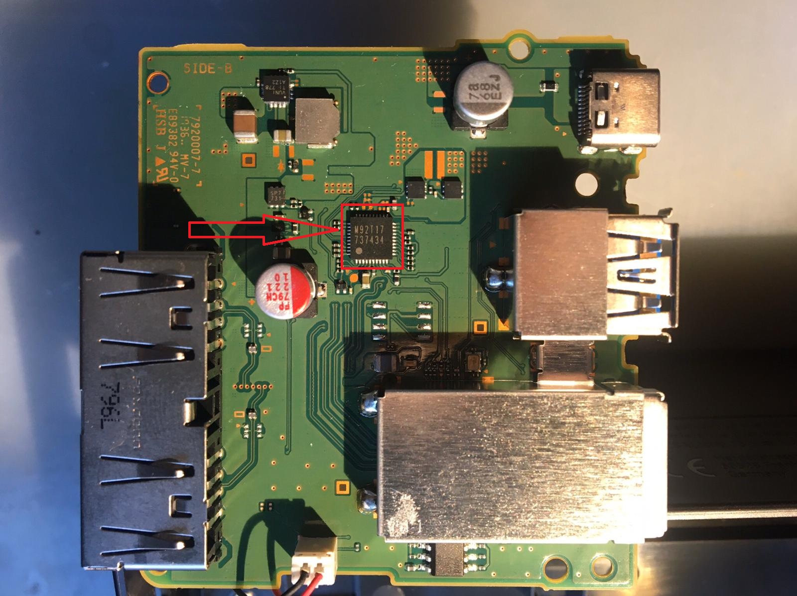

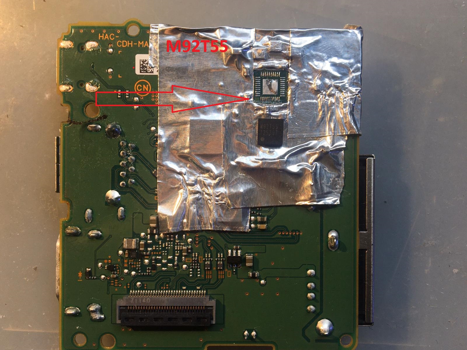

I have a dock that does the same. The problem I think is from the M92T55 or M92T17 Chip NS Power Control IC on the motherboard from the dock. I measured on the board and I did not find any short of the two chips. Has anyone repaired this defect?
I measured and all chokes have continuity. Any other ideas?

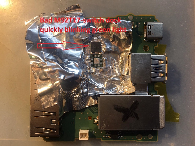

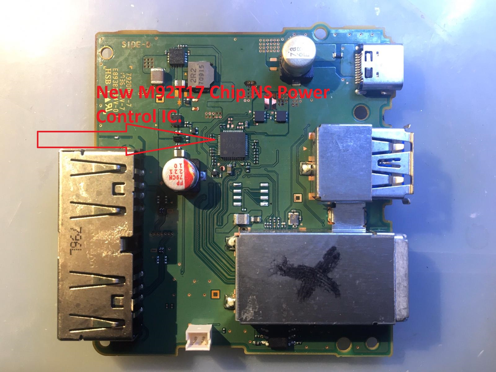

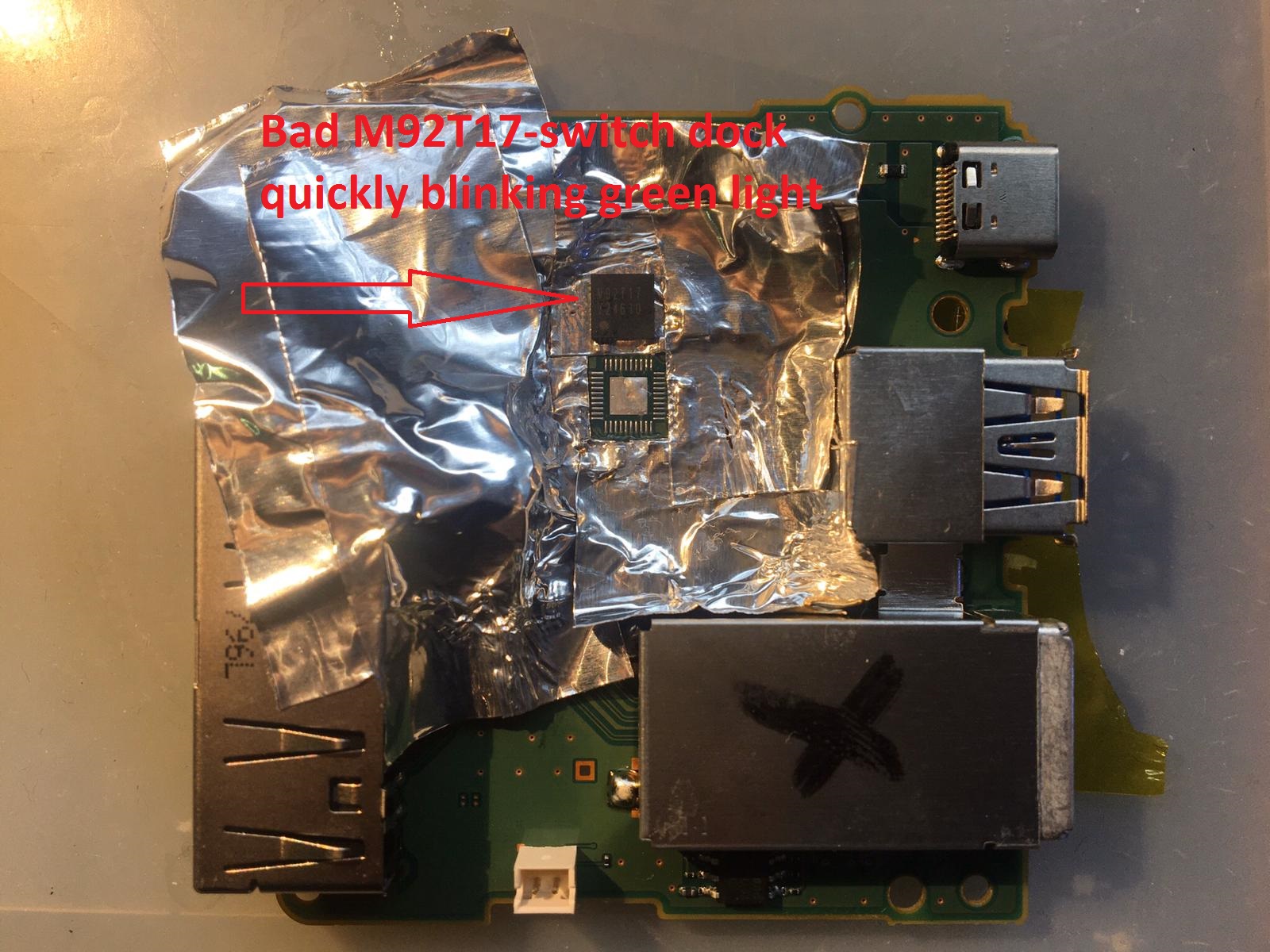

I solved. First I changed the M92T55 but the defect was the same, then I changed the M92T17 and now the dock works perfectly
So, the dock problem that quickly blinking green light was from the M92T17 Chip NS Power Control IC.
