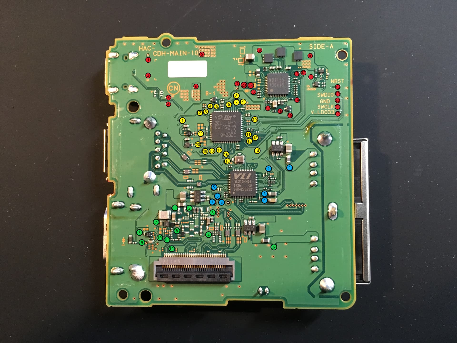

I was replacing the M92T55 chip on the switch dock, but lost a component next to the chip in a terrible tweezers accident. Since I can’t figure out how to upload an image, I will try and describe the location. It is on side A of a cdh-main-01 switch dock board. If you hold the board, so “side A” is right side up, just to the right of the M92T55 are 8 small resistors (?) The missing component is closest to the chip, just above the 5 in a line, and in series with the one component perpendicular to the other seven. Does anybody know what this component is, so that I can replace it? It is the principle of the thing, to do it right.
If I got it right, it should be pin 17 and according to the datasheet the resistor is 100 kOhms

Thanks. That was my guess, but only because the other resistors in that group are also 100k ohm. But when you say datasheet, where is that. I tried looking for a schematic of the board or a datasheet for the chip. I could find neither.

The datasheets for the BM92T10 / -30 / -50 I downloaded from ROHM semi years ago.
