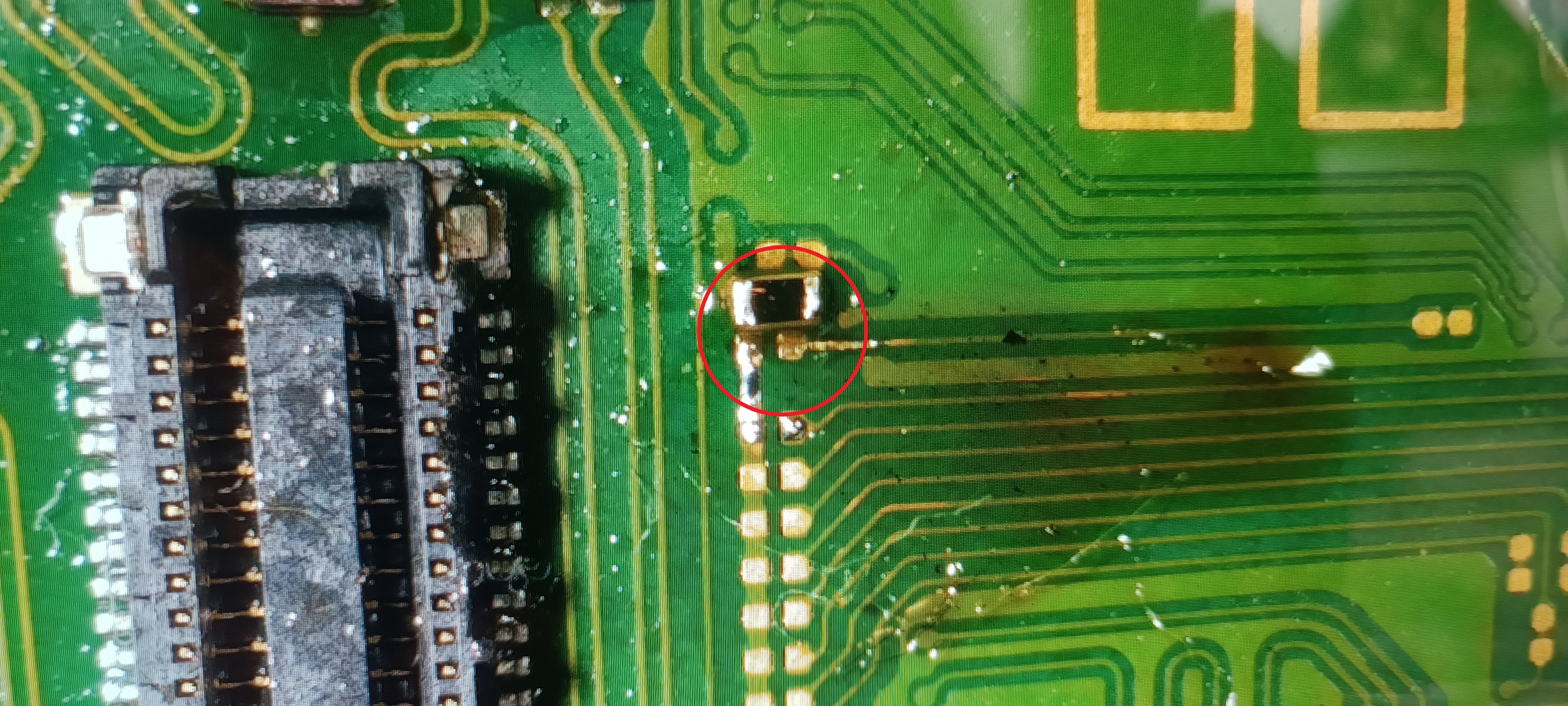

i did found several issues on the mainboard:
- missing resistor right from the eMMC port

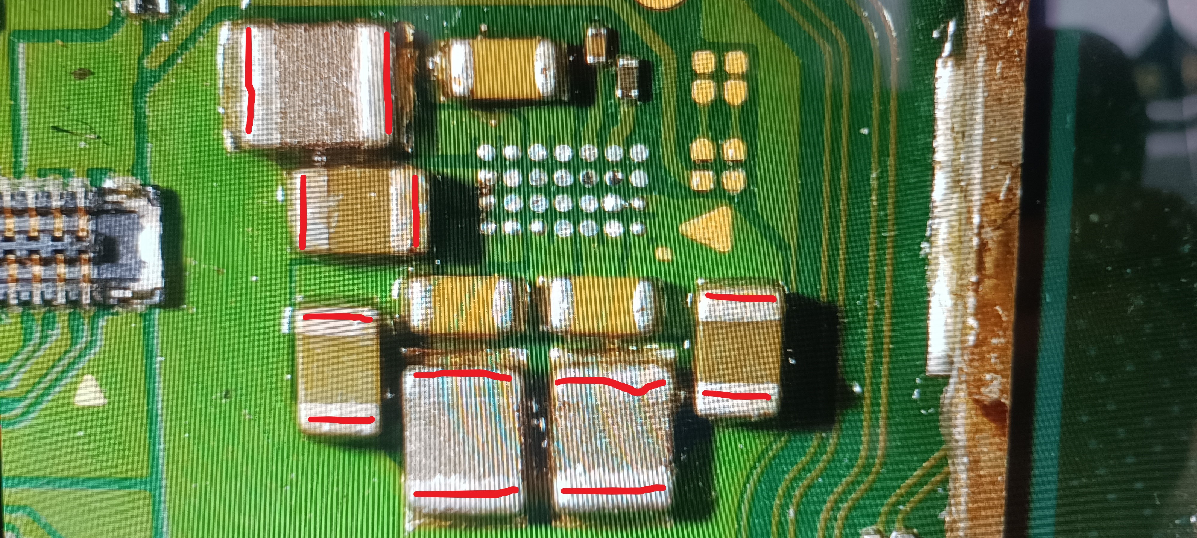

- bad cap left from the Tegra CPU (one of the 2 small ones)
- shorts around the MAX77621 left from the CPU

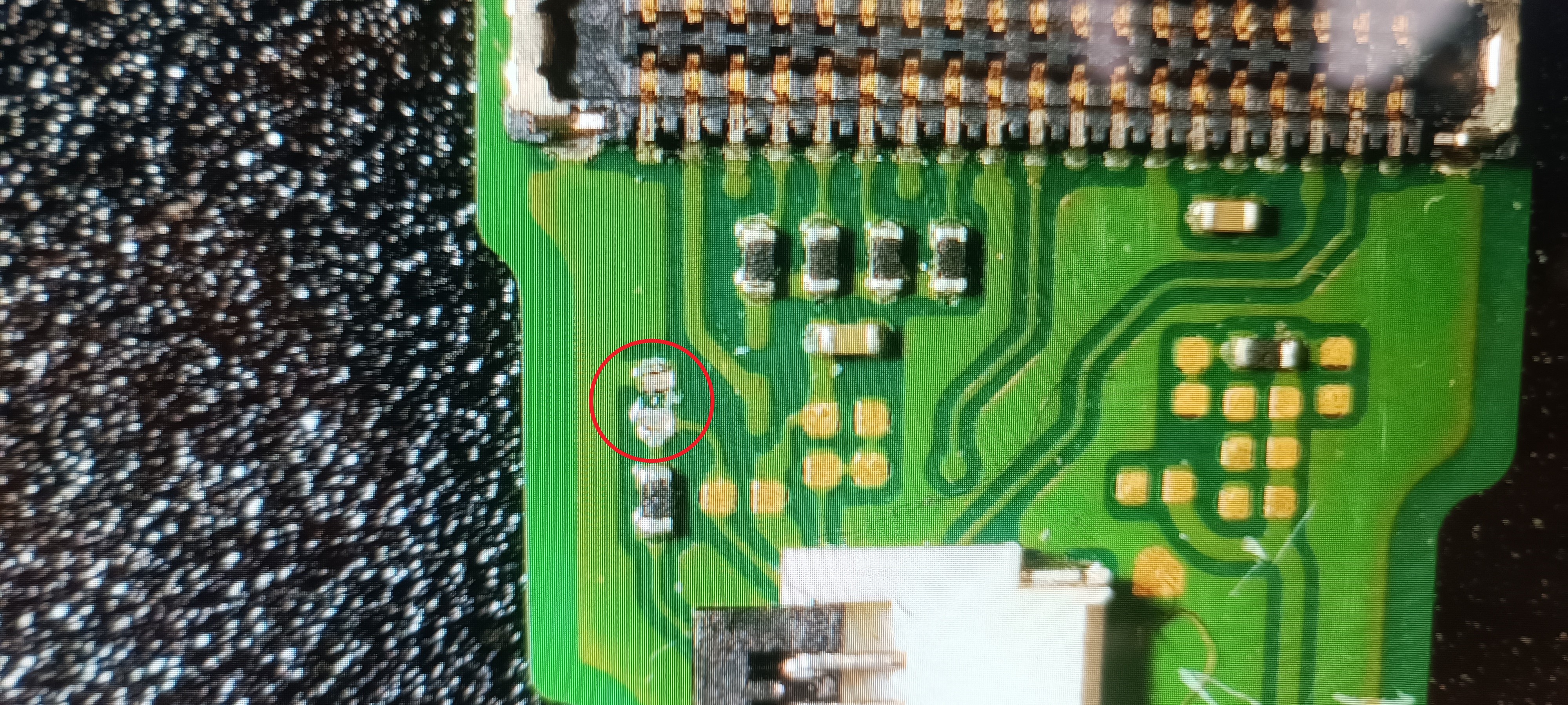

- (maybe) a knocked off component on the bottom left where the gamecard board connects.
anyone knows the value from those 2 resistors and the caps?
is that component really knocked off?
i desoldered the MAX77621 but the short is still there. i have taken pictures and will add them after marking the shorts on the components.
