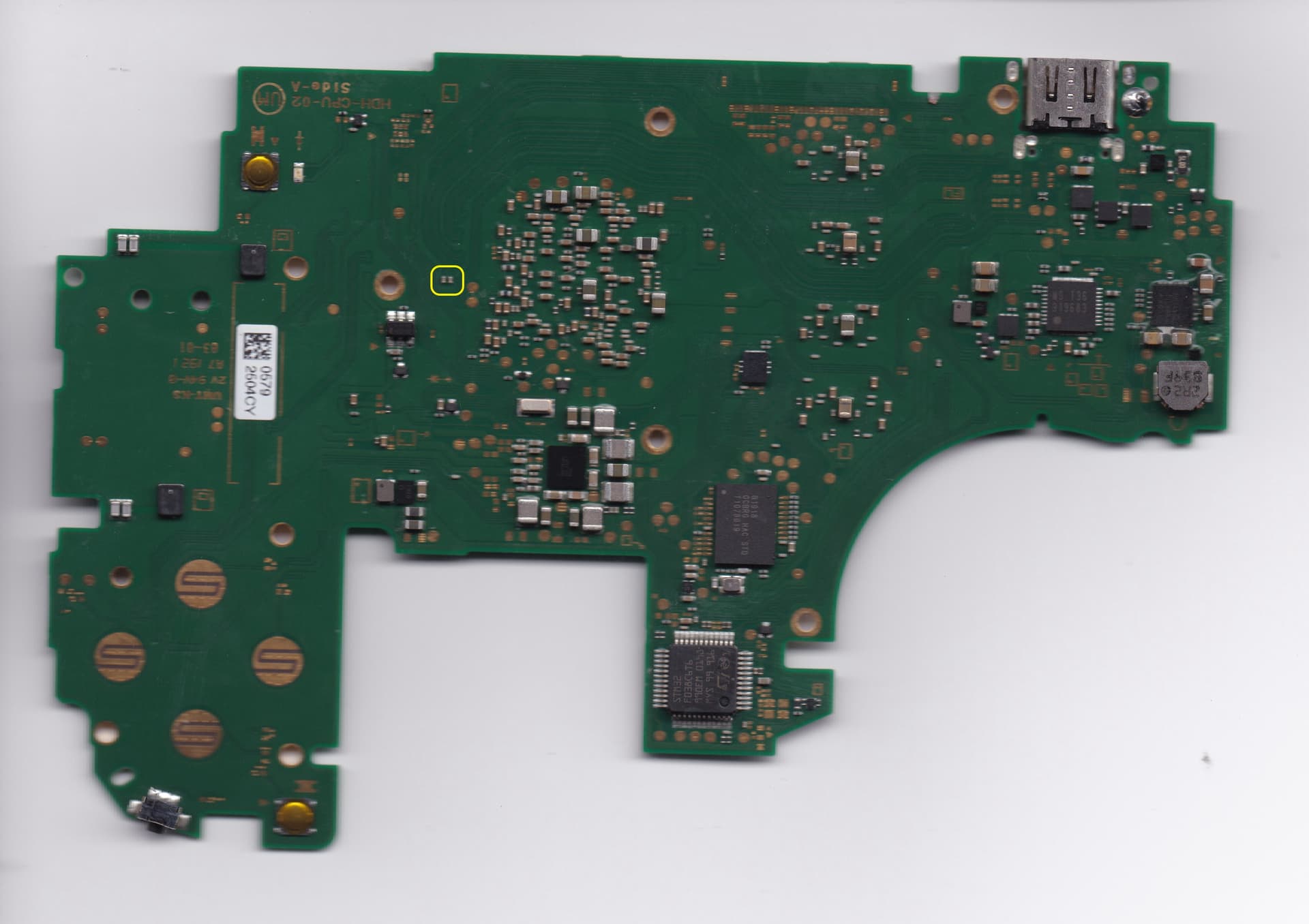

Hi, there’s a topic on reddit mentioning those, I can’t post links as I’m new here but the topic name is
“Nintendo Switch Capacitor Identification, left side APU - Anyone know where I can buy this part and what model it is?” you can find it easily with google.
They should be 100nf 10v 0201

I know that this topic is already quite old. However, I have been just down the same rabbit hole, but on a Switch Lite. Even though the culprit wasn’t one of the two condensators, I thought it might be worthwhile to put the location of these on the Lite on this thread, if someone is interested.
