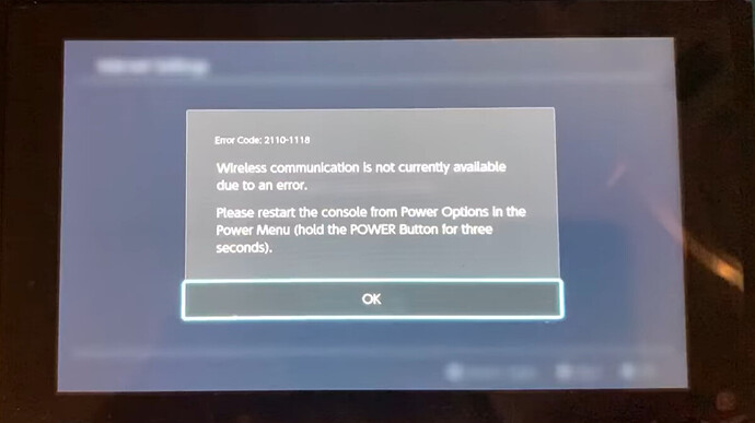

I replaced the fan for this switch and the owner said the Switch worked fine before that. Now it gives wifi error. Fan replacement couldn’t have caused this problem, right?
Is this error software problem or Wifi/BT IC problem? Everything else works fine. Joy-cons work wirelessly and no shorts or damage around Wifi/BT chip.

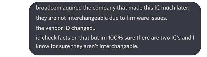

Reballing didn’t help. Problem is that it has Broadcom BCM4356 which is not so common and all of my donor boards have Cypress ICs. These ICs’ has to be taken from donors otherwise they don’t work…
That’s fine, they’re interchangeable. One company just took over the other or merged, the chips themselves are the same :slight_smile:
Really? I thought they are not interchangeable?
I Saw this somewhere…
Yeah for sure they’re interchangeable… that guys wrong :+1:

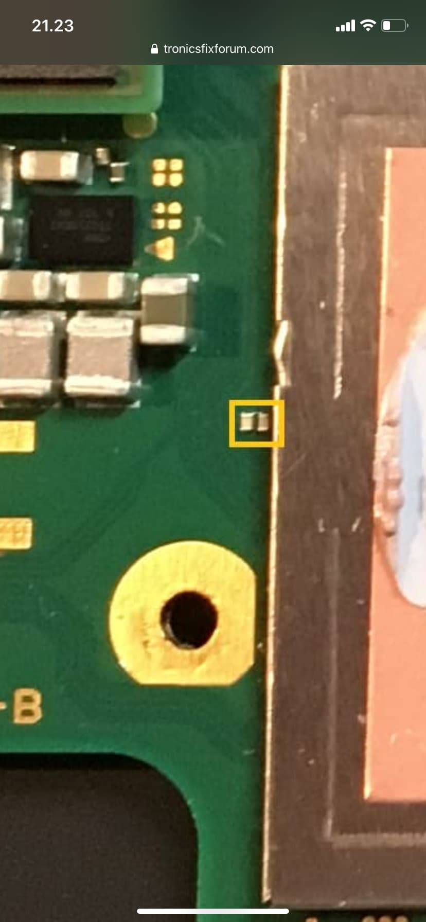

So I have an oled switch same problem, what I’ve found is there is supposed to be two resistors left side of the the cpu, side by side make sure they both are there. I wiped one away with a q-tip.

Bad cap here caused the problem. Switch is now working.
Good stuff glad you got it sorted :+1:
Sorry I should have mentioned the previous poster was reffering to caps and not resistors to save you the wild goose chase :frowning:
