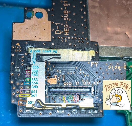

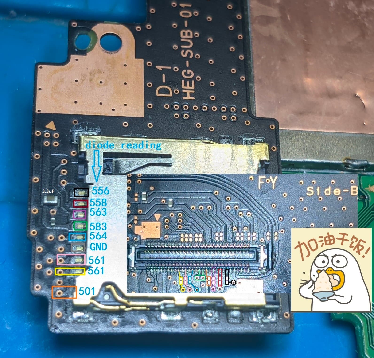

what diode reading on your sd slot without battery or sd card?
