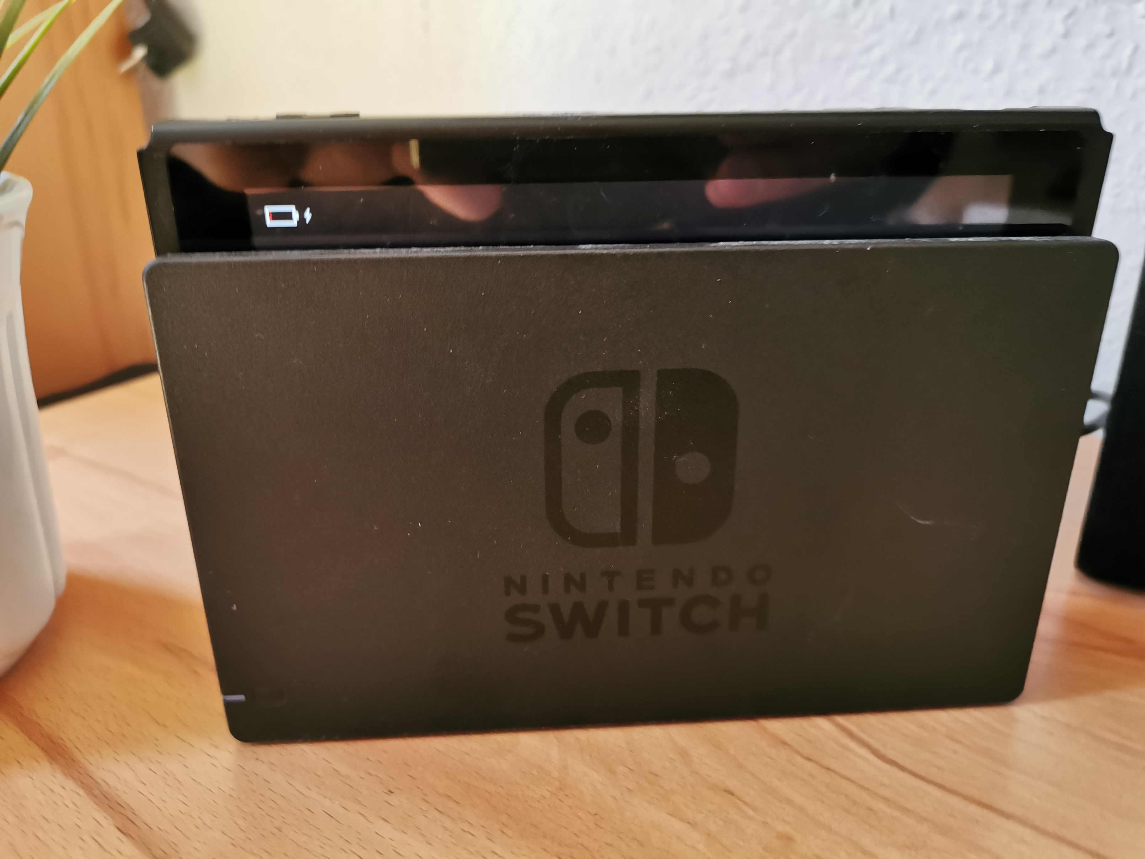

Hey Guys, i need your help,
2x Switches with the same issues.
If i charge, the charging symbol batterie is coming but nothing more, 3hours charging and anything is happening. Does anyone has help?
Second switch the same problem but in the docking station the green light is flashing
