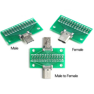

I have this,
Not the seller i bought from, just a similar item
It tests all the pads exactly on the switch usbc board
One row is top pins and one row is bottom pins of usbc
