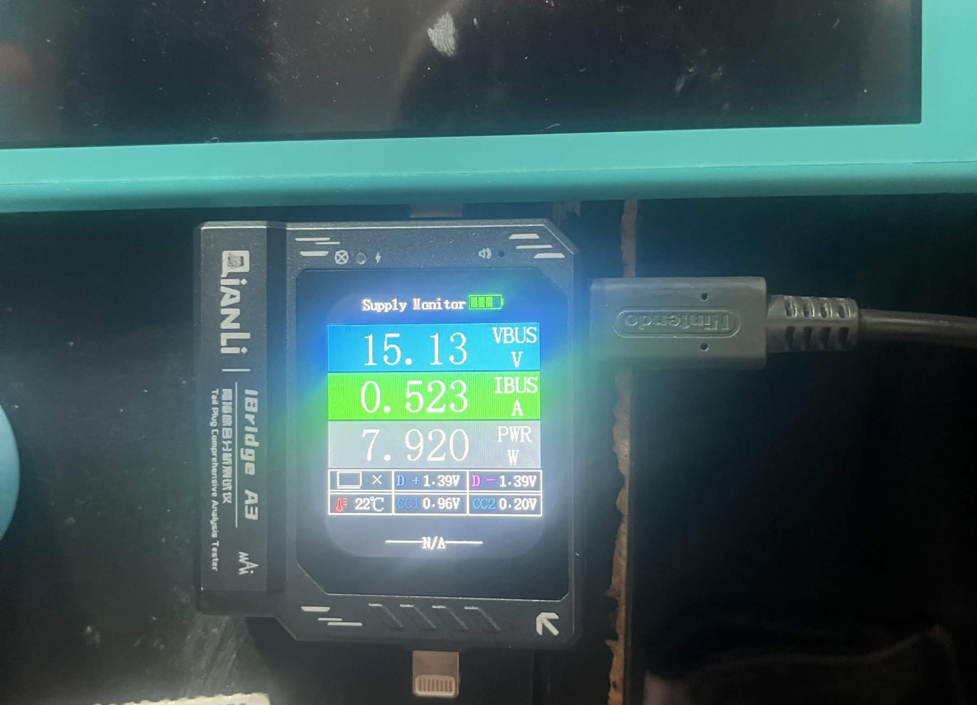

The USB-C port and M92T36 have been successfully replaced, as it now displays 15V and 0.520A on the USB-C tester (before replacing the components I had different values).

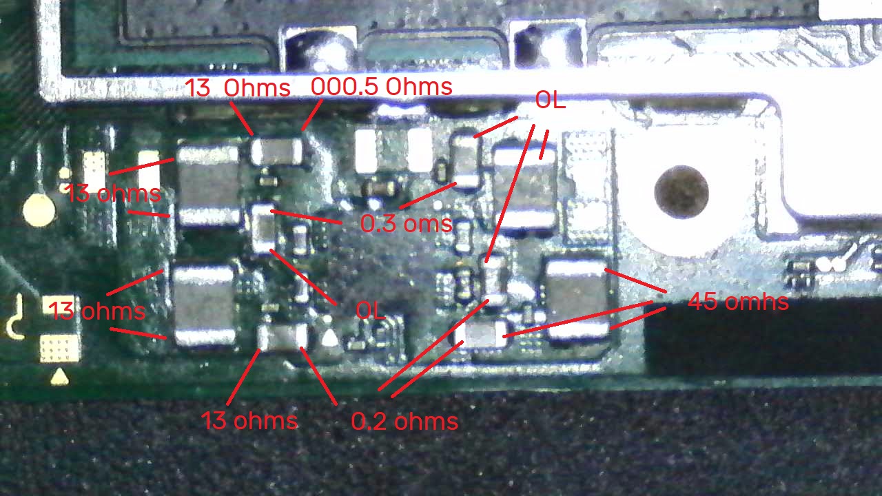

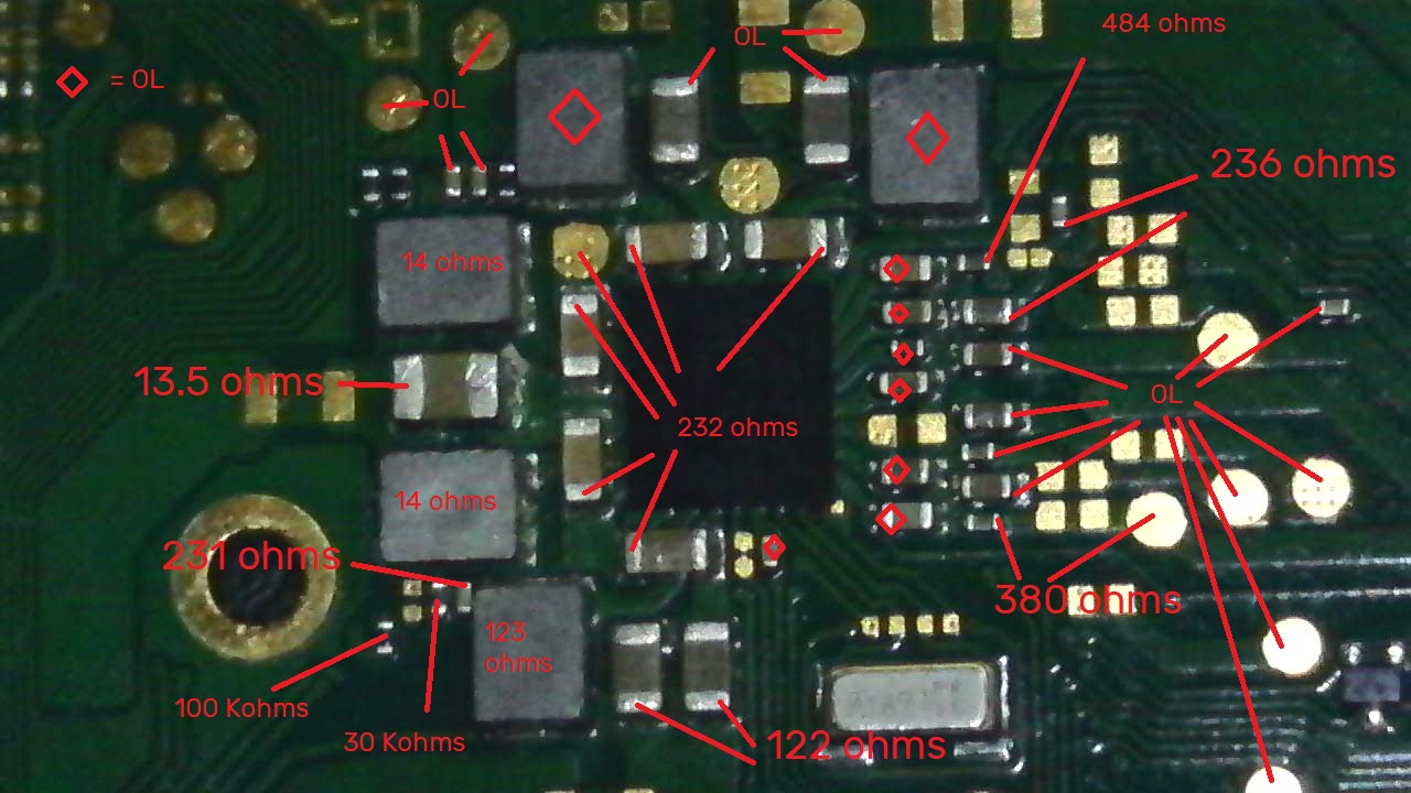

i’ve take measure around MAX under APU and on the other MAX CHIP:
I will give photos when I’ll authorized to do this (I’m new on htis forum)

MAX Chip on M92T side
MAX Chip on APU side
Results on USBC Tester
