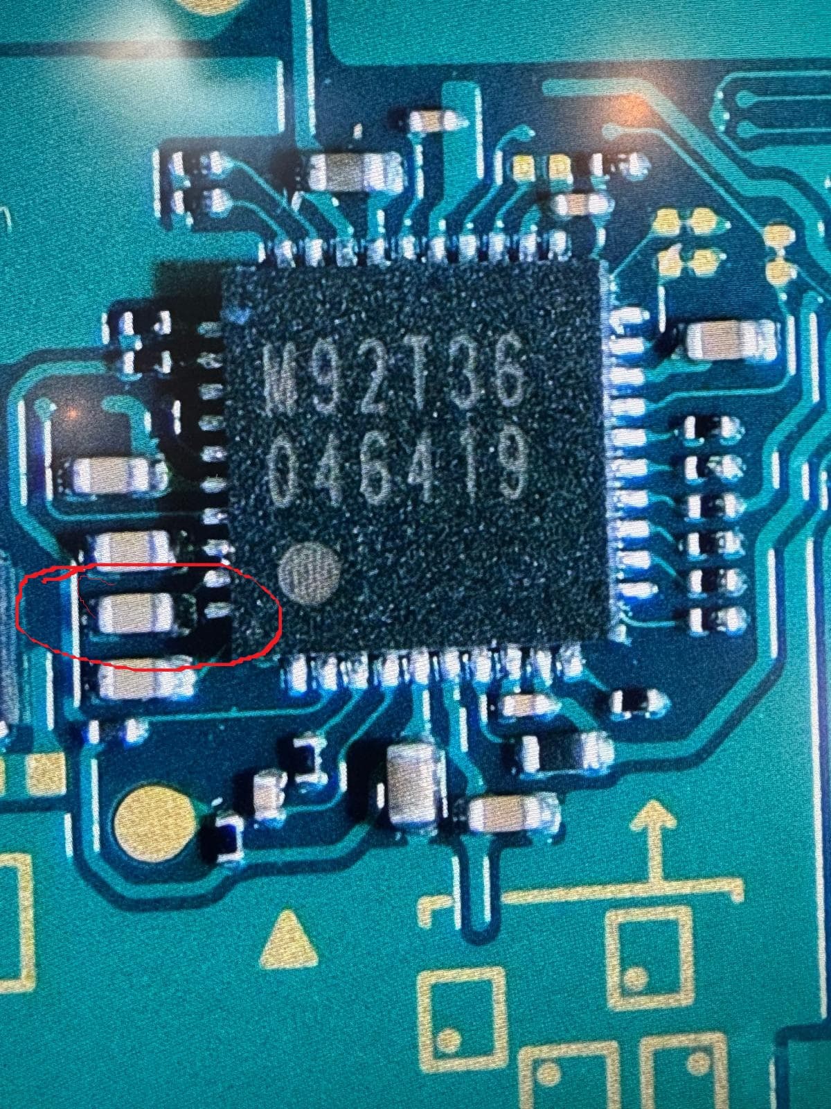

Hi all, I have a switch lite here that had bent up pins on the charge port , I replaced this and still had some shorts around the M92T36 along with the 2101-0001 error message on the screen .
I replaced the M92T36 but still have a short of 7 ohms to ground on 1 side of this cap see photo.
