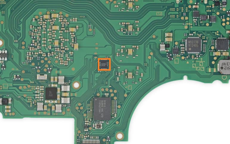

Can any of you knowledgeable people tell me which os the gyroscope ic on the Switch Lite. I have on which is in a permanent left tilt state and if possible would like to swap it out with one from a donor board.
Thanks
Tony
TDK ICM-40607 should be the chip
Thanks Calvin, I really appreciate it!
