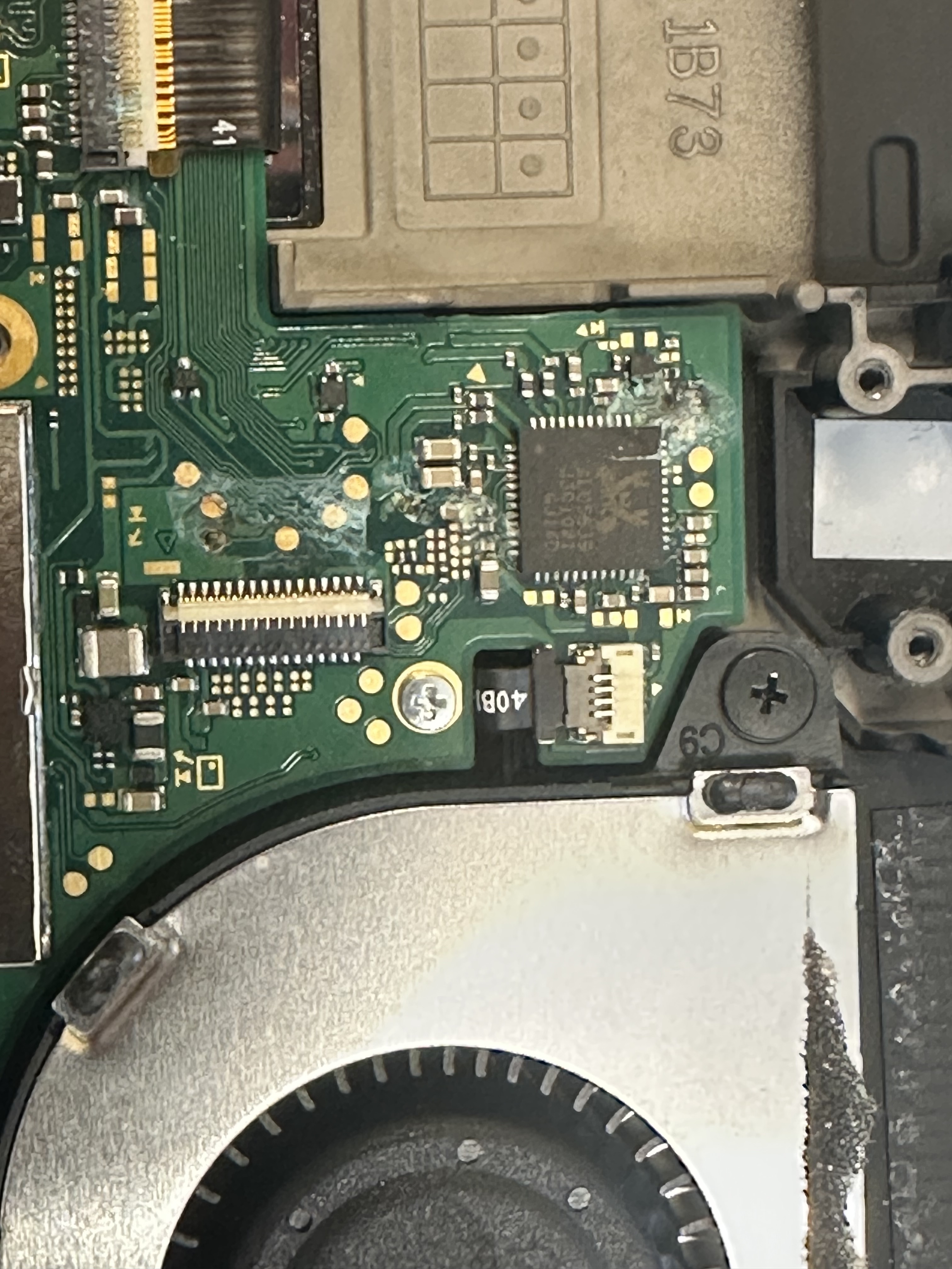

Hello, my lite switch of my son no longer works, I disassembled it and I saw oxidation, I cleaned and changed some resistance the switch is restarted but there is no sound, and from time to time at startup I have the error 2153-0321, I swapped the audio chip with another switch but I have the same problem… I tried another speaker and the same problem… do you have an idea? I’ll post you some photos, thank you in advance
If I plug headphones jack the switch boot but no sound in headphones
show the audio chip area after your replacement.

have you replaced/worked those resistors around the LM damaged area or just the chips?
It is barely impossible to figure your situation without detail pictures
Hello, I circled in red what I changed.
