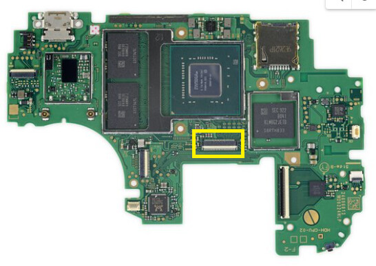

I read about 4V of current on the connector that leads to the mainboard. My research showd that it´s supposed to be around 13-15V here.
I would start by first inspecting the flex cable connector (highlighted yellow in the picture) for any type of damage. Inspect the flex cable itself for any damage such as a broken or corroded trace / pad. Also inspect the white latch on the connector itself for any type of damage / wear as they tend to break very easily especially if you are opening and closing them a lot.
Do you see anything when you power the device on and place a flashlight next to the screen? If you see an image doing this then the problem is related solely to the backlight, if you dont see the image then you are not connecting to the LCD and this must be resolved first as I dont believe the backlight will power on with a undetected LCD (dont quote me here I am still learning too).

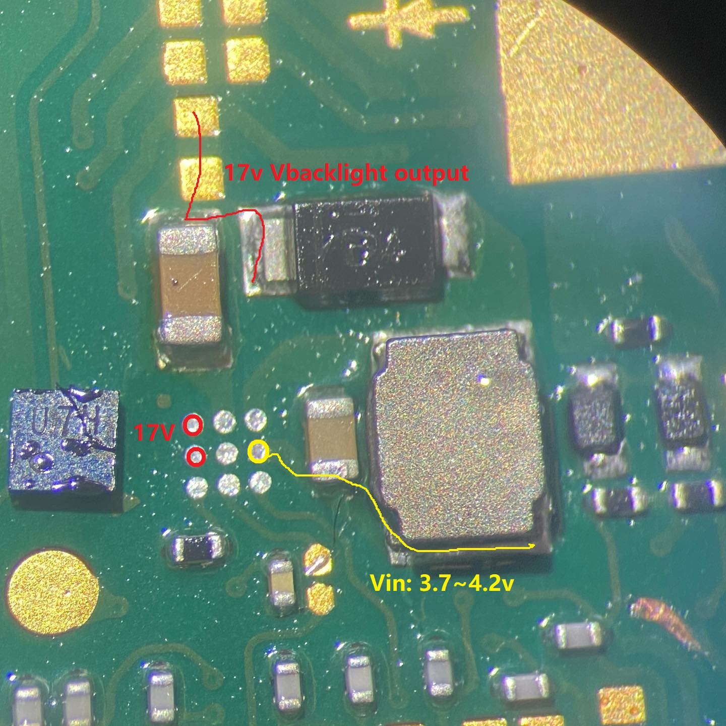

Check voltage on the coil above the extension cable conntor on M.B, ALSO CHECK continuity from backlight cable to M.B side extension cable connector(3 pins from right side)
