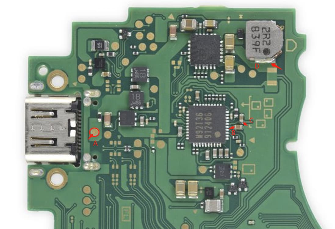

Switch lite no power no charger, it restarts when it starts charging, the m92t36 had a short, I changed it and the short was removed, I changed the charging connector, the voltage correctly reaches the 3 points of the bq, there is 0.12 times it starts to load it tries to turn it on and it turns off again, but not every time I connect the cable, without a cable it does not show the logo or turn on the backlight of the screen.

I can’t find the 3.3v line, I don’t know where to measure, to find the short. or inject voltage.

ok, thanks, I’ll continue researching on the forum, I already did it but I didn’t find my problem, I’m still looking, the only thing I’ve seen is that the 3.3v doesn’t reach me, at the 3 points I know of, the capacitor next to the m92t36 that reaches the processor. the 2 points between wifi and ram…
Not sure which 3 points your reffering to but your probably going to want to check that 1: it’s actually being prompted to boot (either via USB or at the pwr/vol flex connector or at the TP’s) and 2: your gonna wanna check that your ENXX IC is actually being told to enable the output by checking it’s enable signal is high (again, covered on the forum somewhere by me) and of course your going to want to check the resistance to ground on this rail to ensure it’s not being pulled low
At point c I do not receive any voltage and it is the second m92t36 that I change, and I see it well welded, my lite does not have any consumption when I see it in the load tester, from time to time it gets 0.12 and turns off.
in the resistance that is next to point c if I receive 15v.
